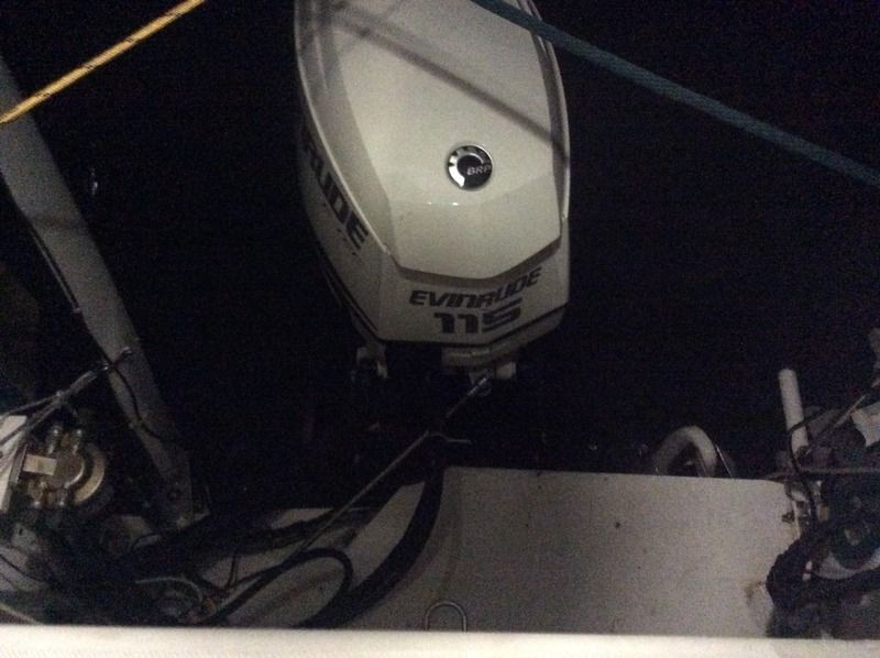

If there's an entry way issue it can be solved with a jackplate offset; Which can help in having the motor lift completely clear of the water at rest (up) & out by as many inches as one would care to increase their back yard. My 10" accomplishes both of these most excellentlysailboatmike wrote:Does anyone see the issue with the 115Hp motor hanging off the back???
The first thing I notice is that you can no longer get on the boat via the transom, with my 75Hp Merc its a squeeze boarding, maybe not such an issue if you have nice high floating jetties so you can step over the side, but imagine trying to get back in from the water if you go for a swim, voluntary or not
The next mod you'll want to do - or in tandem is covering the steering bars with 3/4" starboard with traction.
While probably not the best night pic. You can see how entering & exiting is no longer an issue with a jackplate & my 115; swim ladder is in the water on Port side rear.
