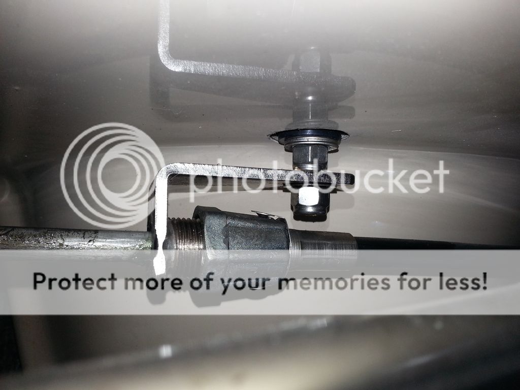

Does anyone have any photos or diagrams of how a rotary system connects up to the Outboard and rudders?

At the top of the page, click Resources, then Manuals to download the manual for your :macm:. Page 18 shows the info you are asking for.

Does anyone have any photo's of their Rotary Helm fitted in their :macx: / :macm: console?
I'm having LOTS of fitting issues with my new Dual cable Rotary (UFlex T72FC) into my console and it looks like I'll need to cut new holes and move the Rev counter up.
I'd really like to see how others have accomplished this (even with a single cable Rotary helm) .... so some photos of the inside of the console would be a big help. :)

At this stage I most likely will machine a new helm box out of HDPE or equivalent. I have the tools to cut the 6 sides then route a groove and rabbit joint for assembly. I have round over cutters for my wood shaper so I can radius all the edges like the OEM. The sides will be removable like the present design. Everything will machine fit and be assembled with stainless screws. I haven't worked out the measurements as yet. The box will have to be taller with the wheel shaft higher in order to raise the Rotech gear housing vertically. If you install the Rotech on the OEM helm box the gear housing just clears the binnacle tube and there is not enough clearance for the cable to bend in an arc before entering the tube.
Neo, my boat is still in the drive so I checked the oem wheel position relative to the binnacle box. Thewheel plastic cover collar is approximately 1in below the bevel. I don't think you could add a cover plate over the wheel hole and remount the Rotech and have enough distance from the Rotech gear housing and binnacle tube to bend the cable. The other issue for me is my motor controller is internal so the helm box is to narrow. Overall my options are to build a new box so the bevel point is approximately 2in. higher. The box could be built to the same height as the OEM with a flatter bevel for gauges. Or keep the same proportional dimensions with the overall height 2in. + higher. Another thought would be to build an integrated vertical instrument cluste/nav pod.
