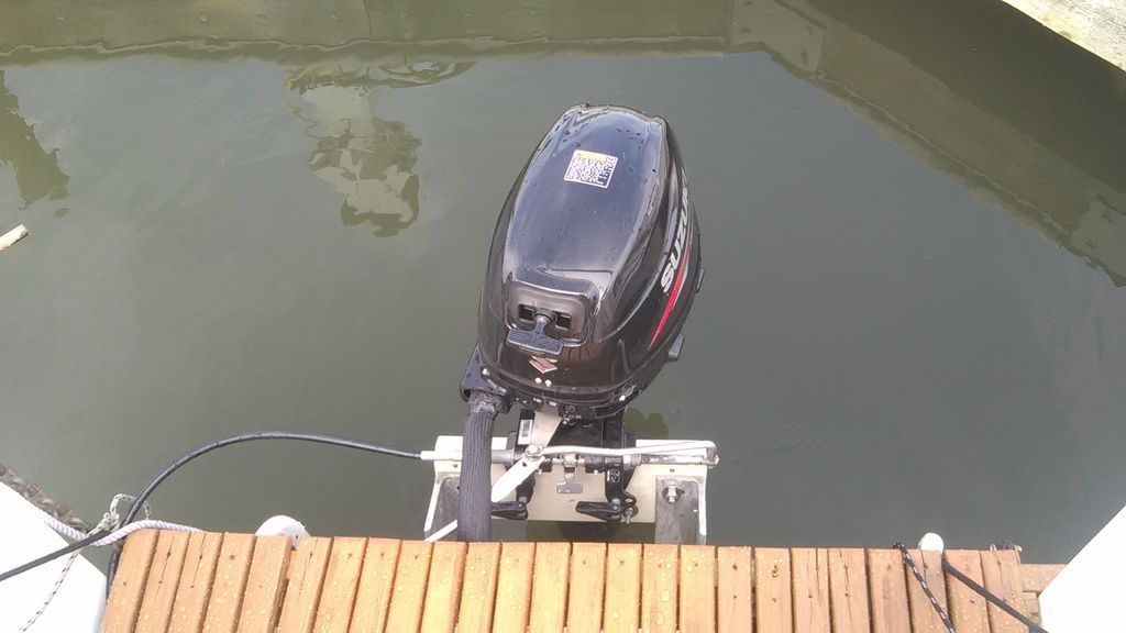

Is there a offset "sweet spot" anyone has found for how far back you can bump without having to go to power/hydraulic steering? 6"? 8"? 10" seems to be over the line for sticking with factory setup from what I've been reading. Gazmn, can you re-link pics of your setup? Thanks!
- Devin
We were looking the steering over last night and we think we can do a 6" jack plate by using a longer connection rod to the outboard.
I know a few have gone bigger, but I can't find any good pictures of the steering linkage. Can someone upload some?
I'd also love some first-hand experience. Can anyone provide some opinions?
Jeff

To clarify, Jeff and I are working on this together - those are our boats together ready for surgery ;-)
We got the motor off mine last night and pushed the ETEC 90 up to it on a stand to get a sense of space and standoff. As Jeff said, 6" appears to be a safe bet, just trying to get assurance from someone who's done it.
Without further input our current plan is to order a 6" manual jackplate and 5 degree wedges (with beveled hardware) for each boat, most likely through Bob's Machine, over the next few days. I've tried reaching out to Bob's for some advice from them but keep missing their tech support (I've called and emailed). Hopefully we can touch base with them soon.
Any input would be appreciated!
I put a 6" jackplate on my :macx: when I switched from the honda 50 to suzuki 90. I had a 2002 :macx: with stainless steering syetem, I think the older were aluminum and a different setup. If I remember right I used rectangular aluminum tubing about 2" tall and 4" long and bolted it to the end of the original steering bar to extend an drop it where it attached to the rudder crossbar. That gave the extra length and rise needed. On the 6" setback I think I raised the motor 2-3" to run right, so linkage had to be raised and lengthened. The angle of the lengtherned steering bar reduces full stering to the motor so docking can be more difficult.
Eventually I ran the steering cable straight to the motor, felt it was a more solid setup with a 90 and eliminated the reduced motor turing radius issue. That worked so well I went to a 10" jackplate when I switched motors again to a little 20hp.

Great feedback, Seapup! I've seen running the cable straight to the motor mentioned a couple times but I haven't looked at the mechanics of this yet. What's involved with that and what are the downsides?
Thanks!
