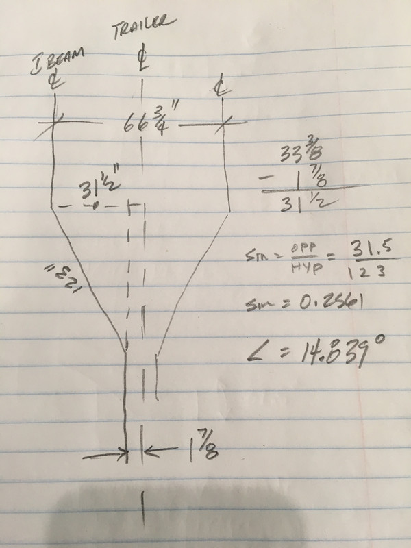

Yes, the I beams are 20 feet long. I took a whack at the bend radius and it looks like 33-36 inches.
The 14.5 deg offset doesn't seem too bad, until you start trying to control it and make a uniform radius without kinking it. I think it's doable though.

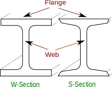

As Tom pointed out, you're bending the easy axis, so the 5" web might not be much worse than the 4" if the flanges are about the same.
