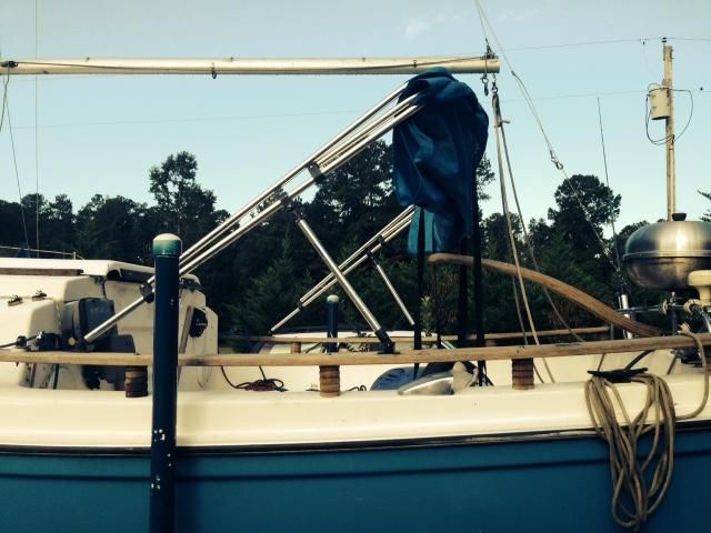

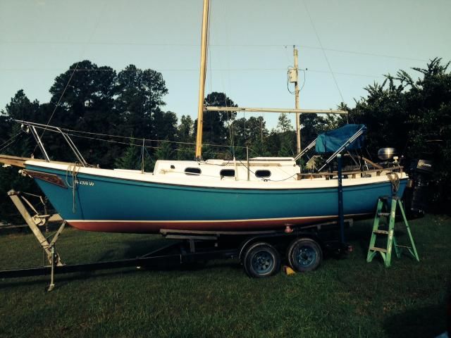

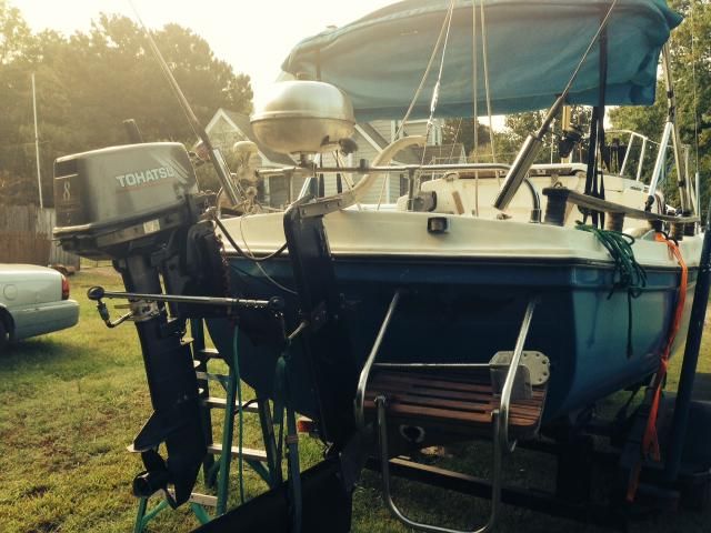

I finished the rail and the Swim ladder.
Putting this on created a few issues so I had to do some other work to make it all fit. The Bimini Top used to lay flat, but now that the rudder goes between the boat stern and the rail I can't lift it up high enough to raise/lower the bimini.
Solved this by taking some SS rail and leftover bimini top hardware and built this. Sorry, in the pics the Bimini is not rolled up and covered as it normally would be, but you get the idea.
I like it, it makes the boat look so much more "expensive" and it also got the bimini off the back taffet rails, which is where I prefer to sit while sailing/motoring. I Used quick connects at the bases so when trailering and lowering the mast the bimini lies on top of the rudder. I built a mast crutch out of a life ring mount. When the mast goes up the bimini is lifted and the back support poles clip in and its stored above our heads and looks o so cool. the Crutch is removed from its mount and stored below....it's about 3ft long maybe and can be seen sitting on the swim platform in the first pic.
I am having my upholstery girl shorten the mainsail again by about 6 inches. I would like to be able to sail with it up. Right now I CAN sail with it in the new stored up position, but the boom isn't high enough to OPEN the Bimini. I own an industrial sail-sewing machine now. I bought it and its at her place and she now can do sail repair. Since its my machine I get it done free :-)
