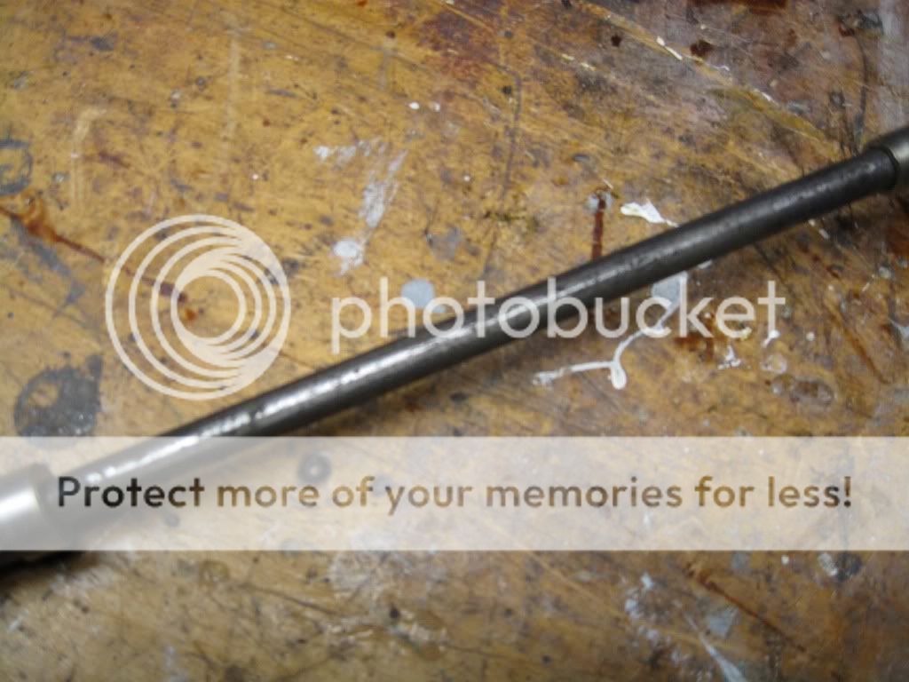

how and what did You lubricate? The only parts which I can access are the gearing at the top end and the piston on the bottom end of the cable. As You will see the piston is quite erodet. I grinded off the rust and lubricated this parts however no improvement was observed.
Have You been able to remove either the piston or the gear rack from the cable? I think this would be the only way to lubricate the cable itself.
Rainer

Yes I removed the cable from the rack and lubricated the whole cable
Read earlier post to see how

What I´m going to do tomorrow I will thrill or grind a small hole (3mm) into the outer part of the cable just below the rack and fill in some oil

Be very careful drilling you probably will damage the inner cable
Just get a hose or pipe and fill with oil and work the cable it will lubricate itself
Allan

I agree do not cut the outer, they are usually made from spiral wound wire, if you drill, cut or grind the outer cable it will probably break in two.
I followed Allan’s instructions and it worked a treat
