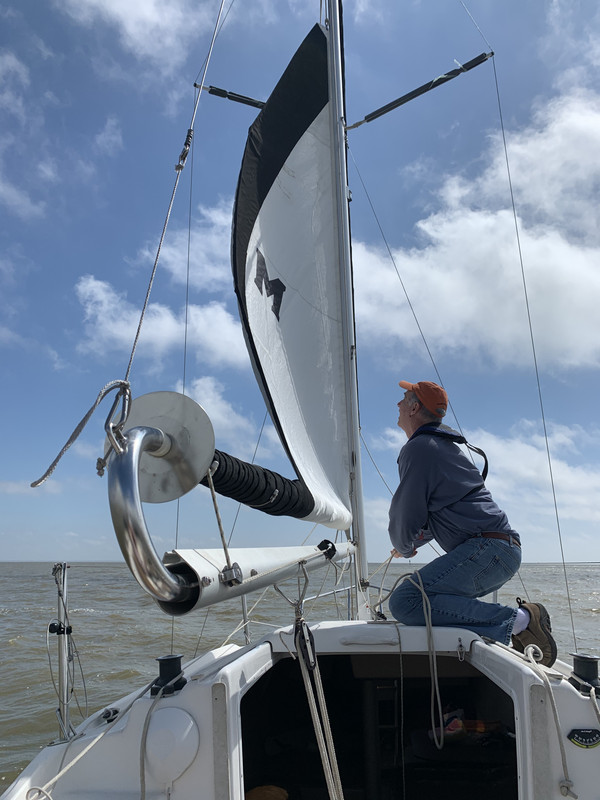

In that picture if you let out some mainsheet the sail would have been much easier to raise (or lower).
Do your stanchions have sliders or something?? What's that black thing on them?
I want everyone to notice the huge size of the topping lift in that picture
*You forgot to take the noodles off your spreaders)
No I never mentioned that you need to be on deck to use it - when I used it I did everything from the cockpit working two lines at the same time very much like a genoa furler. I am still very curious about that harken flux capacitor you seem to be messing around with a lot.
What I did say was that you were leaving the boom and sail on the deck when TRAILERING and STORING. Most of us can not do that but I do agree it would be a lot more convenient if we could.
(Who is taking the picture?)

BOAT wrote: Tue Mar 31, 2020 6:32 am Yes, your furler is the Mike Inmon furler.

Thanks. I thought it probably was an Inmon furler.
Actually, I may have been trying to take some belly out - which also would have been easier without all of that wind pressure on it. Whatever I was doing, I wanted a closeup view of it.
The port stanchion has a black ball bungee on it that holds my cockpit lifeline when I'm not using it (which I wasn't).
Don't judge a man on the size of his topping lift. Came that way from the PO. Hasn't made it to the top of the list yet...
Yes (actually pipe insulation); and when we ran upriver to dump the ballast and let the Etec take a deep breath, one of those came off. Fortunately my daughter saw it and we were able to gather it back up. Hate littering.

My.baby daughter, now 23, took the picture. It is the first time we've gotten to go without a lot of other folks. Her mom was working. Love all three of my daughters, and it's nice to get to spend a little time getting to know what kind of adults they're turning into. Hard for me to do in a crowd. If the weather stays good, may try again soon. Pollen is really bad though right now.

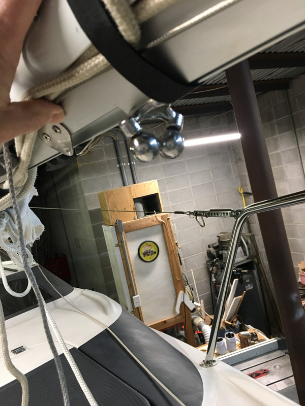

Did Mike have an adjustable topping lift? Mine is fixed. I was thinking of adding another snap shackle or similar to the lift to give me a raised boom setting for furling. Yes, I've fooled with it, but it really needs two settings.

Jimmyt wrote: Tue Mar 31, 2020 6:44 pm Did Mike have an adjustable topping lift? Mine is fixed.
From your photo, and thank you for that photo, it really demonstrates how this system works, your topping lift IS adjustable.
There appears to be a piece of line from the loop of the topping lift to the carabineer to the boom. You could easily add another carabineer higher up. That's how mine works. BWY added 2 clips on mine. One for sails up and another for more headroom.
My 2 hook solution.

Thanks Russ! I’ll copy your setup if the boom allows me to lift it significantly.
If you zoom in, you can make out the vertical bracket that goes from the boom up to the roll. You can see that the boom and furler has twisted counter clockwise such that the vertical bracket might just go to the port side of the mast if I raise the back end of the boom. It’s flopping back and forth when I tack due to slop in the gooseneck connections. I’ll have to watch for wear over time.

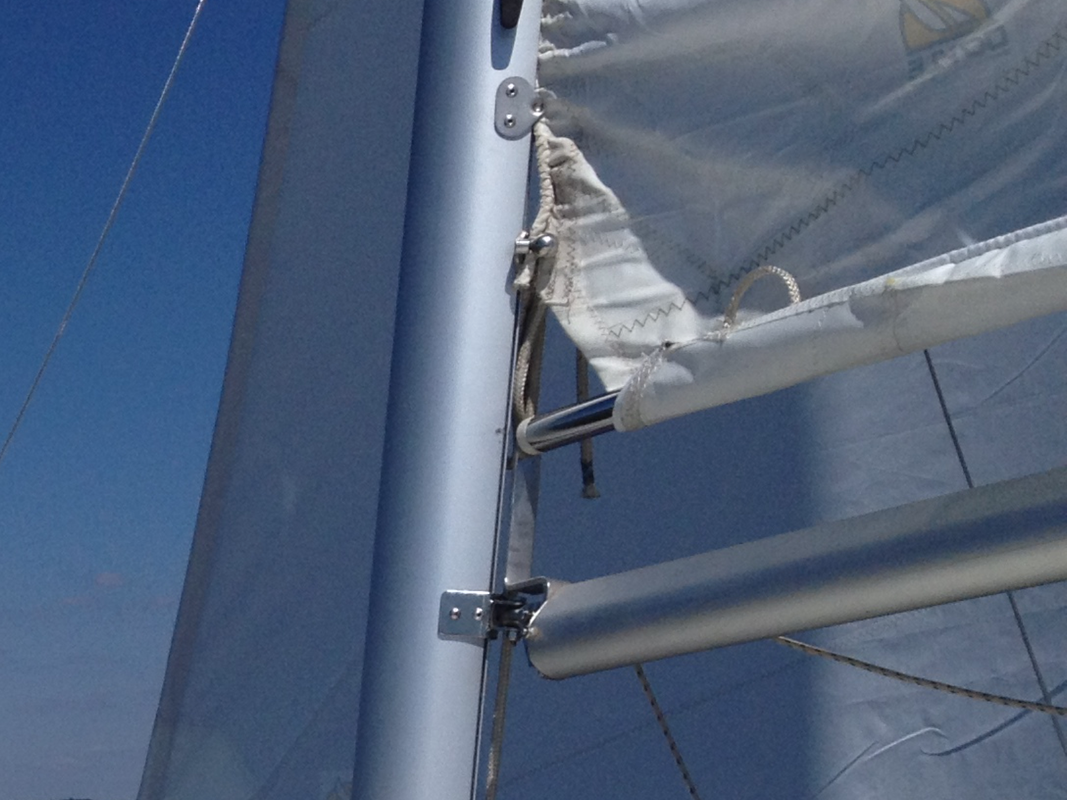

The Inmon furler raises the foot of the sail about 10 inches above the boom putting a lot of torsion stress on the gooseneck. Furling booms are not supposed to have a single gooseneck - they are supposed to have double or triple gooseneck because with in boom furling you are using the boom as the reefing cringle instead of a proper mast cringle so it really puts all the strain of the sail tack on the boom instead of the mast during the most stressful conditions - when the wind is so strong you need to reef.
Most in boom furlers use a double neck like this:
I learned my lesson the hard way on this one - I tried to make my own roller furling gooseneck when I first bought the boat.
(Man! was THAT a disaster).

BOAT wrote: Wed Apr 01, 2020 6:35 am The Inmon furler raises the foot of the sail about 10 inches above the boom putting a lot of torsion stress on the gooseneck. Furling booms are not supposed to have a single gooseneck - they are supposed to have double or triple gooseneck because with in boom furling you are using the boom as the reefing cringle instead of a proper mast cringle so it really puts all the strain of the sail tack on the boom instead of the mast during the most stressful conditions - when the wind is so strong you need to reef.
Agree completely with your concerns.
