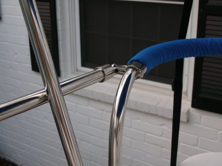

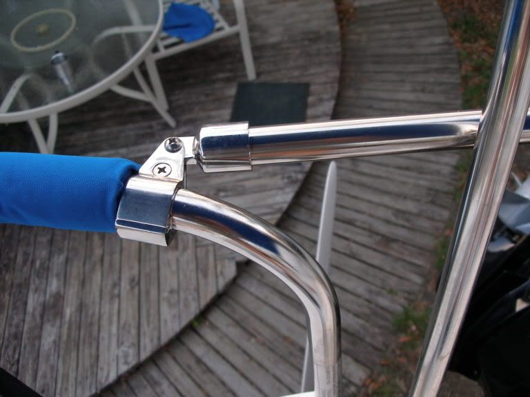

I've added a section of 1" SS tubing in between the stern rail seats to further close in the cockpit and it functions and looks excellent. Makes the assembly rigid and also allows me to tie in the mast crutch which will also firm that up as well.

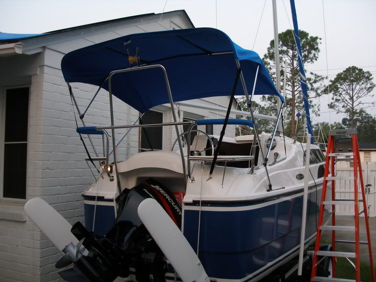

Trying to mount a bimini today. $320 Sunbrella Blue from Boater's World. Don't think it will be a classy as the $???? from Dowsar. How much was that puppy?

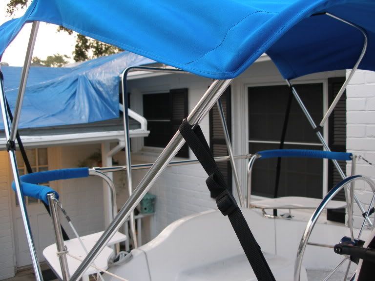

Just made some rail covers from $2 pipe insulation foam and some spare blue sunbrella fabric. Cool

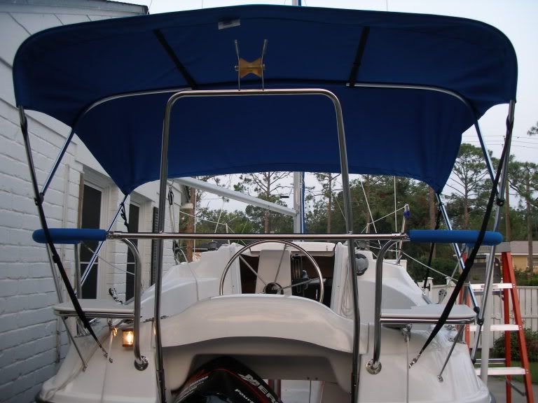

Here are the GREAT photos that came from mtc.

It crackes me up to see a guy that does all that beautiful custom work on his boat and has a tarp on his roof. Now that's a sailor!
