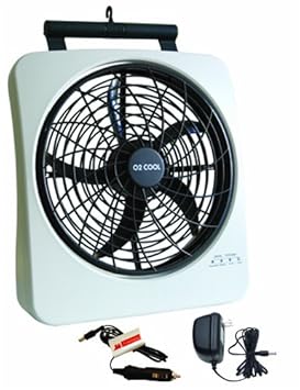

If I was going to do A/C on my boat, I'd probably do a built in unit with water cooling. Use a small genset like the Honda 1000. Proper cooling just takes a lot of energy. More than can be stored in a battery. That water heat exchange gadget does look intriguing.
Or, as I used to do, use those small O2 fans. Work great. We've never spent a night at the marina (plugged in).
