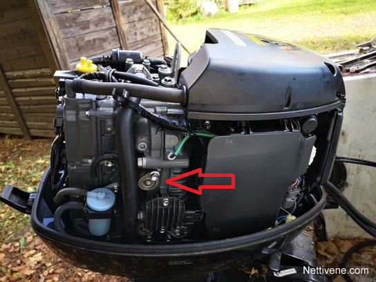

Would anyone here be able to tell me the location of 2001 Suzuki DF 50 internal anodes?
I have the spare anode kit, 3 external anodes and 4 internal ones. The external ones are very easy to spot but I cannot figure out where the internal ones are located.
I find a lot of videos telling the location of internal anodes in the larger Suzukis but nothing about this one. Even the service manual tells the location of the 3 external anodes but not a word about the internal ones.
Could it be that there is no internal anodes in this one?!? the spare anode kits specific for this motor certainly have 4 little round anodes in addition to the 3 external anodes that are easy to find.

I just replaced 2 anodes on my Suzi DF70. Easy to spot. Youtube videos helped. Can you post a pic of your engine? Might help identify where?

Thank you for the reply. Below a couple of pics. All help appreciated.

Should be starboard side behind that vertical hose.

Thanks a lot! A bit embarrassing if this is really so simple. Will try to get to the boat again tomorrow. Will report asap.

Finally made it to the boat. Sorry for the delay and thanks for the comments.
Below pics from behind the hose. No anodes there either. I recall this df50 is MY 2000. Checked 2005 df40 which I thought was basically same but yo my surprise it did have anodes behind the hose! So the pics below of the -00 df50.
Perhaps it does not have internal anodes then?!?
All further comments welcome. Would definitely want to change the anodes if they exist.

It's possible there are none. I'm no expert on outboard motors, but I've never heard of anodes until recently. I changed mine this year, after 12 years, but they looked fine and probably didn't need to be replaced.
