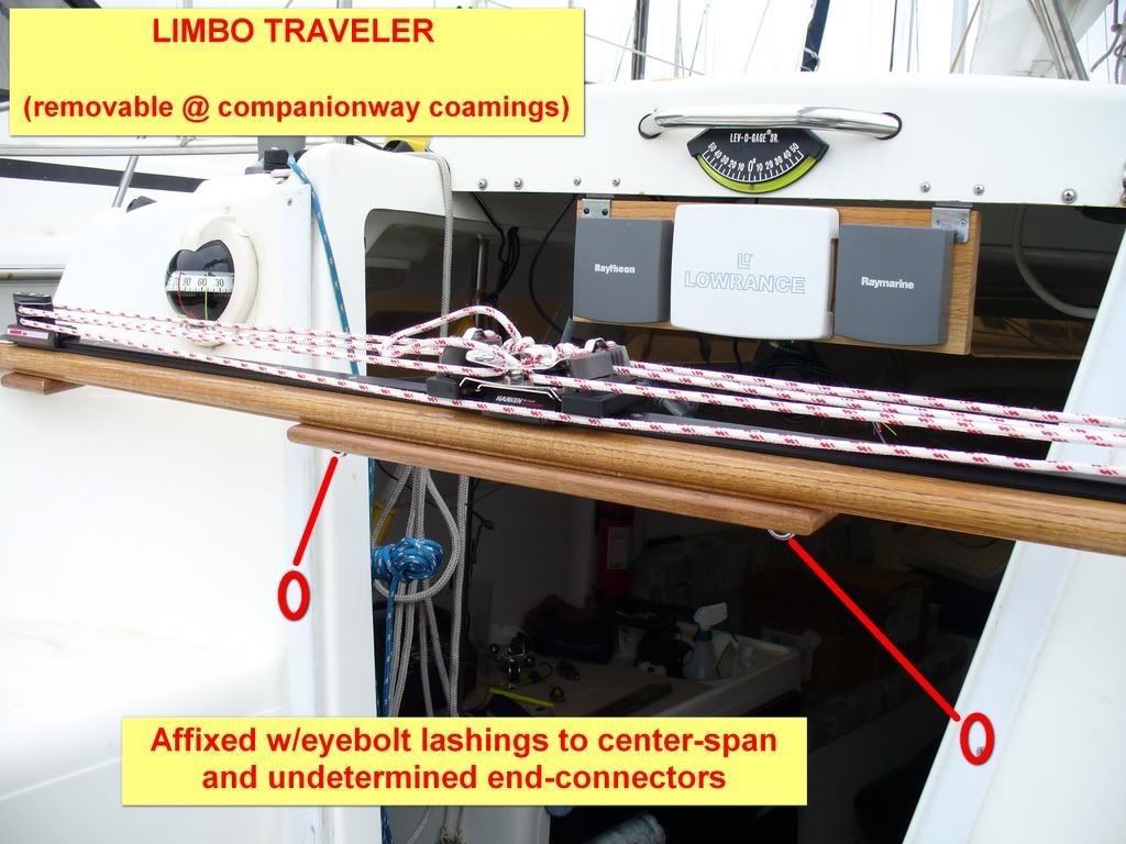

Following shows my hinged instrument panel ... folds under the slider when moored.
Small speakers flank this panel left & right, but they're folded back in this pic.
Short answer is, I mounted tiny scraps of 1x2 (little wooden blocks) to the slider with hinges from HmDepot (they corrode quickly!). Then I disassembled the computer satellites and used their base-mount screws to attach to the wood blocks. Ya gotta wing-it on that part.
The major problem with this strategy is wire management. Wires must be arranged and secured so they will move with the sliding hatch, yet not droop into the cabin headspace. Ya gotta wing-it on this part too. In picture you can see one of my instrument panel wires draping under the slider, extending into the head. You can just barely see the starboard (black) speaker, folded up under the slider.
