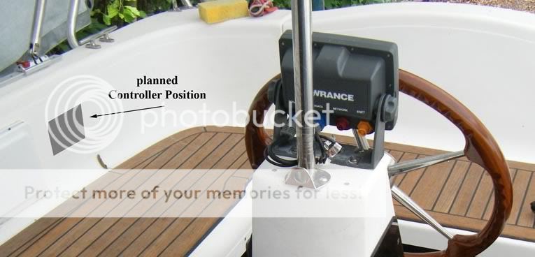

Thanks to Jose and Boblee, now I´m satisfied. As soon as it becoms warmer I´ll start mounting it.
I´m still not sure about the position where to mount the Smart Pilot Controller because no space is left at the pedestral (RPM and Outboardtilt is there).
As it should be in reach distance from the steering seat and I´m righthanded the only place I can imagine is to the starbord side cockpit wall. I know, Jose has made bad experiance with the controller installed close to the companion way
Any other idea?

- J.Teixeira
- Posts: 344
Re: Current thinking on Autopilot for 26M?
Hi Rainier
Mi controller is on the right side of the companion way.
It is not very practical place because to steer before passing to auto it is difficult.
In mi Dehler I have it on the pedestal where it is much useful...
I am moving mi controller in the Mac to the pedestal and install the wind computer on is place.
But I am still thinking about it...
All the Best
Jose

- c130king
- Posts: 2730
Could you attach it to the port side of the pedastal on that dark piece of plexiglass coverplate?

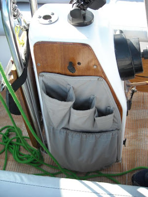

- J.Teixeira
- Posts: 344
I am thinking on putting it on the side of the pedestal.
On the little empty above the bags.
Maybe...
Jose
