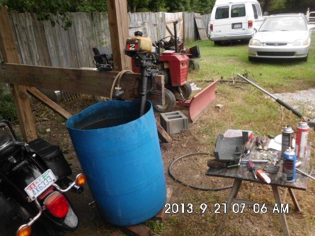

Got the little 2 hp mariner running pretty quick (being a boat mech has its advantages) and it runs great.

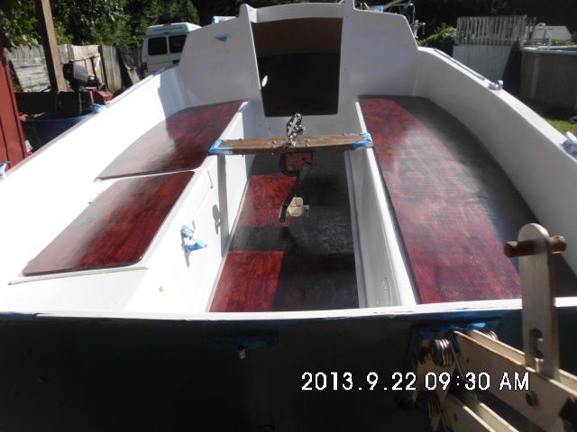

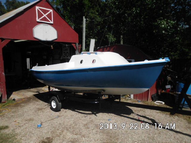

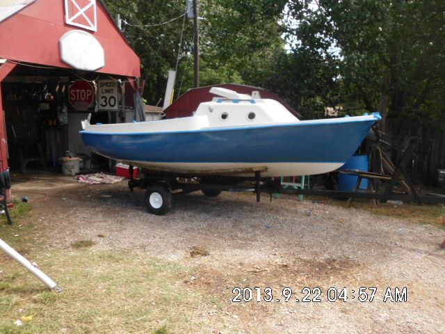

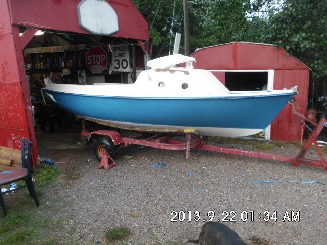

more updates on the little ship
Painted the trailer
Painted topside white, and final coat of midships blue
Sneak peek at the wood paneling trim

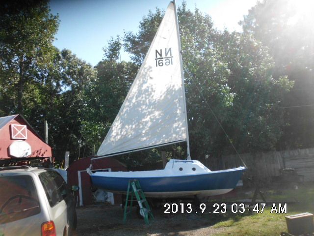

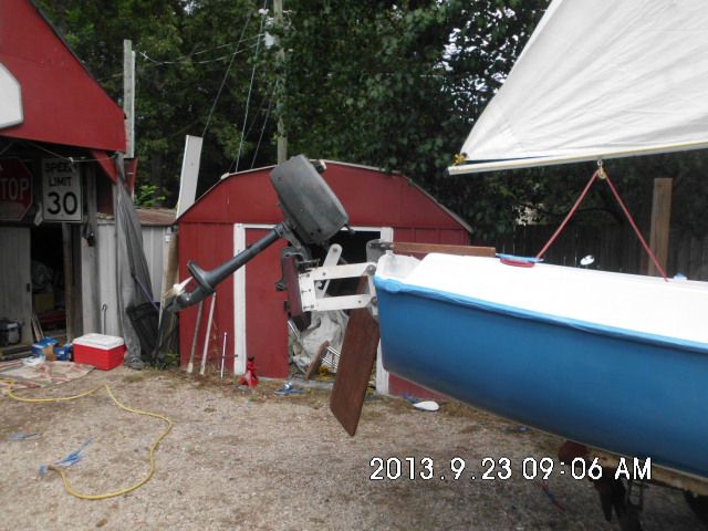

Few Updates :
Little ship is almost done....wood trim is in
Motor mount is built and motor is installed
Sail is up

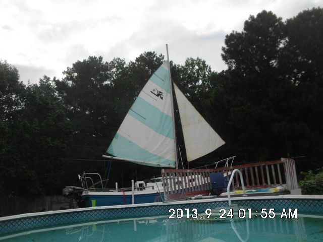

I decided to keep the original Hobie "lake sail" because I like the blue and white, and the sails that came with the little boat look like old motel 6 sheets...Plain white with some stains that look like (well, use your imagination)
The new lake mast for my venture is 2 foot taller. However it has 3 pullys, mainsail, jib, and a flag. So I can run the sails AND my pirate flag out at the lake.
In this pic you see the new Lake setup in construction progress.. I had to use the other set of longer stays from the crackboat, the ones I had with the first lake mast were not long enough (and I didn't cut the extra off intentionally for this reason) so when we did it I underestimated where to attach the forestay and went to the furthest one. I need to bring it back to the first one....
The little ship came with FIVE sails. one mainsail, and 4 different sized jibs including one that is so small it looks like it should go on a toy boat. I assume it is a "storm jib". I ran a pulley on the front of the mast on the little ship, and am going to see if it will work as a "jib" and make the little boat look better for re-sale. i think it would be too small for the bigger venture even as a lake set up...the other 3 are good and different sizes anyway and I doubt I will ever be sailing in huge swells in a storm out at falls lake...

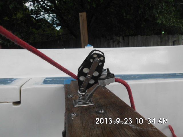

One other thing...on the little boat what is this pully called, and how do you thread it. I know it's for swinging the boom, but not sure how to rig it up. I have one side of the rope cleated off and just ran up 1 pulley for the moment...it's working at the moment but I know that is not correct
Posted: Tue Sep 24, 2013 9:19 am
by Catigale
You need another 'single block with Beckett' aka pulley on the boom to rig that double block in the picture.
The line will run....becket on top block, first (upper on the lower block in pic), now back to the upper block, now back to the lower block on the pictured block, and finally out to the cam cleat.
Hint - its a lot faster to rig these 'backwards' starting by feeding through the cam cleat FIRST....took me three years to figure that out.
