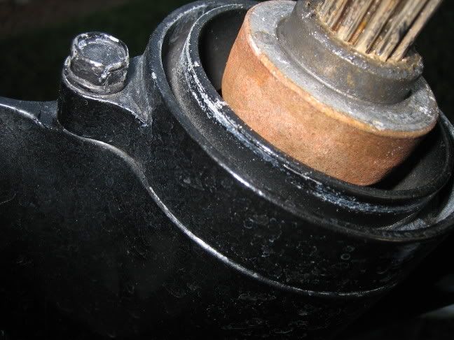

I still haven't been able to try the Solas - if anyone else is thinking about ordering this prop for a '05 and later Suzuki, make sure that Solas has the prop hub machined so that the inside of the hub will not rub the inside ridge of the lower unit. See white streaking.
What's distressing is that Solas knew about the problem ("we have had a few of these past 12 monthes after suzuki improved thier painting anticorrosion processes.") but is sending these out anyway.
I had the machining work done and now the prop will fit all of the way down onto the thrust washer. The machining needed is inside of the hub 1.5 mm deep, and 15 mm length in from the edge of the hub.
Solas suggested machining 0.5 mm depth and the hub still rubbed (see Lower Unit photo above). I had to make two visits to the machine shop to get it right. Can't wait to try it out . . . .
Solas suggested machining 0.5 mm depth and the hub still rubbed (see Lower Unit photo above). I had to make two visits to the machine shop to get it right. Can't wait to try it out . . . .-
grease the spline shaft
Mark Karagianis, that spline shaft looks quite dry of grease. I was told that it is important to use waterproof grease on the prop shaft to preserve your ability to remove the prop by preventing corrosion.
