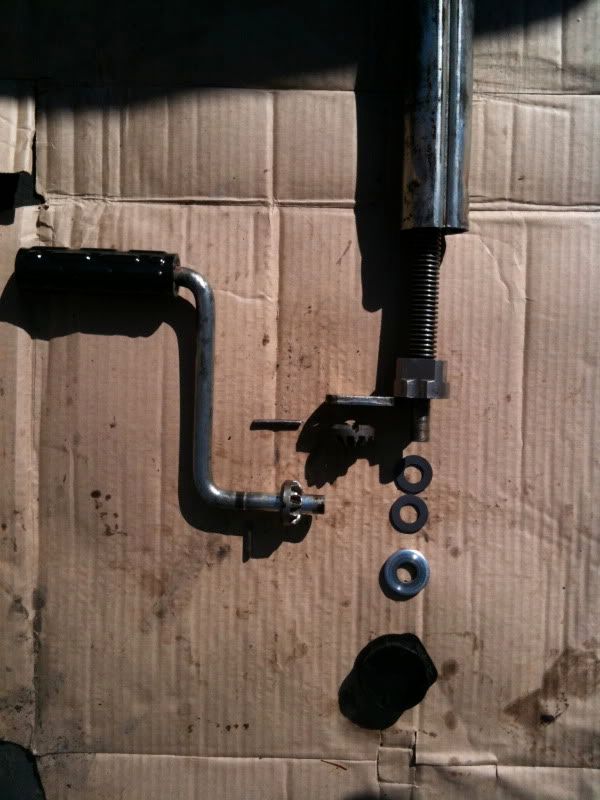

- Posts: 1786
Re: trailer jack
Had a chance to take a look this evening and will post some pictures on Friday.
It comes apart really easy.
- Posts: 1786
Shelby MacX Trailer Jack 2002 Exploded diagram picture
For archiving purposes - sorry the picture is a bit contrasty - not used to sun in NY in April

Re: Shelby MacX Trailer Jack 2002 Exploded diagram picture
Thanks, I always wondered how those things worked inside. Tried to visualize different options, but couldn't ever come up with a good one.Kelly Hanson East wrote:
