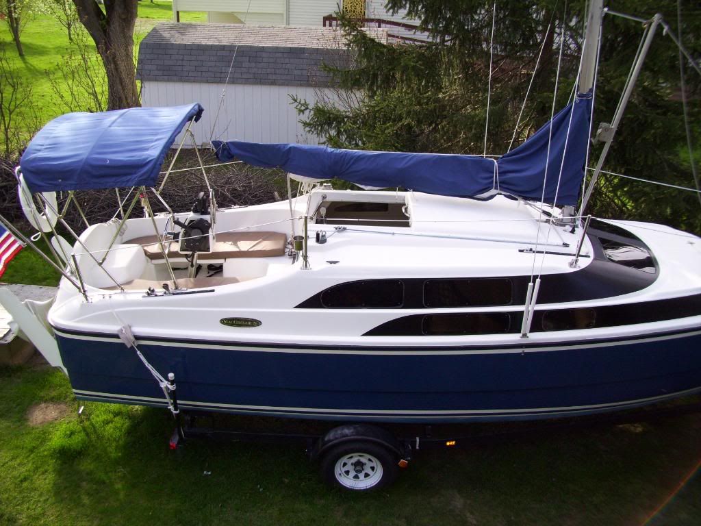

Thanks.. I have to lower the mast one day this week as I'm trailering to the Lake on Sat. Morning... will try to make some sense out of it with the Mast down. If not , I'll have to wait for someone to show me how it's done. If someone has close-up pic's of how the furler connections are made w/ descriptions that would be a great help. I didn't understand the lingo at that website as this is fairly new to me. Here's some pic's of what I've done so far... Yes, the mast raising system is still in place as I didn't even attempt to try the furler and Genoa..Yes, the Furler is attached to the Bow & Mast. Any comments you all might have would be appreciated. Thank You !
BTW...my furler has CDI printed on it.

The steel framed trailer (not aluminum) and photo of the stainless steel drum cover (not plastic open drum) tells me you have a 2007 or earlier 26M that is prior to release of the MacFurler from the factory in February, 2008.
Use this link for the CDI owners instructions: You may also call Tom for help. He's in NY, the number is on his site.
You will need to furnish your own messenger line, about three bucks at WalMart. The most confusing part will be about the ferrule. It needs to be hauled all the way down with the line inside but the ferrule outside the foil extrusion. Make sure you have about three rotations on the drum before winding it with the sail on:
