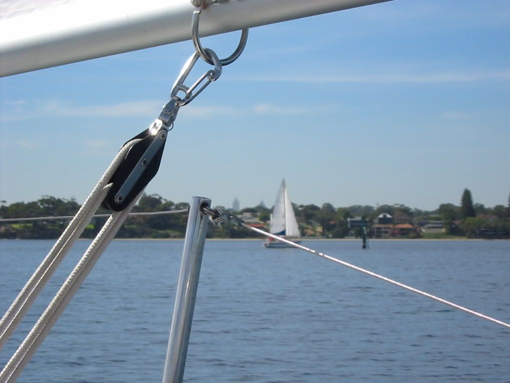

I have been using a snap shackle to attach the mainsheet to the traveller since purchasing our :macm: in 2005. We trailer-sailed our first season, and it was definitely a rigging time-saver. Now it is handy for getting the mainsheet out of the way when we are in our slip. You can see the shackle in the lower photo of this mod page, which details our upgrade to a 5:1 rig http://macgregorsailors.com/modt/index.php?view=1091
