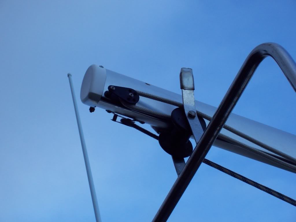

Your mast top should be as simple as this...
this is a photo of SEAHORSE's mast top brought to the stern support...Just a rope halyard through a pulley...
