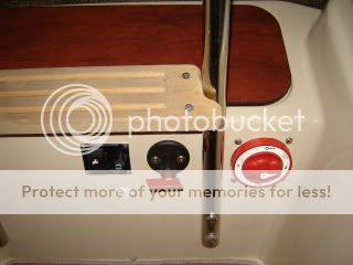

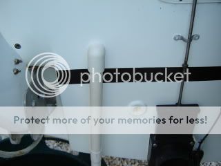

trip
Here's my mod switch on consul panel
http://i844.photobucket.com/albums/ab1/ ... 010018.jpg
W/D pump inside aft S/B side eng well
http://i844.photobucket.com/albums/ab1/ ... 010015.jpg
Access panel from inside open
http://i844.photobucket.com/albums/ab1/ ... 010011.jpg
closed
http://i844.photobucket.com/albums/ab1/ ... 010045.jpg
eng. well outlet & acces deck plate
http://i844.photobucket.com/albums/ab1/ ... 010055.jpg
hope this maybe of help

Highlander, how did you screw or bolt in the pump. I am wanting the screws to be concealed inside.
Kind Rgds
PS Just noticed that my external installation is part way on a bend in the fibreglass. May not accommodate the flat deck plate. pm 19.1.10
See the pics I posted above it is mounted on a 4" x 6" plastic cutting board to strengthen the transom were I mounted it
I bought the deck plates new 8" or 10" cannot remember I would have to measure them for $7. at my local marine flea market :)
