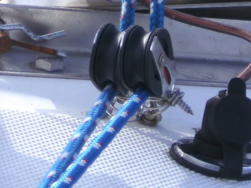

- c130king
- Posts: 2730
Re: Mainsail Downhaul System
A couple of pics.
Above you can see the blue halyard/haul-down line on the starboard side. I tie the loop around the horn cleat when the main is up. Whether up or down...because it is a continuous loop...the blue loop in the cockpit stays the same length. Never have an issue with lots of line in the cockpit when the main is up.
Here is a pic of one of my sets of double blocks. The Original owner just screwed them into the fiberglass deck and the one eventually pulled out. I just recently pulled out all the foam from inside the cabin and drilled a hole all the way through the deck and used bolts/washers/nuts to secure these blocks...works great now.
And here is a bit of a close-up of the turning blocks. The middle of the blue line is in the cockpit...two foot loop. The lines going up one end...the halyard...goes through the turning block at the top of the mast and down to the top of the main. The other line is the haul-down and is tied around the top-most sail slug.
Hope these pics help you understand. Let me know if you have any ???'s
