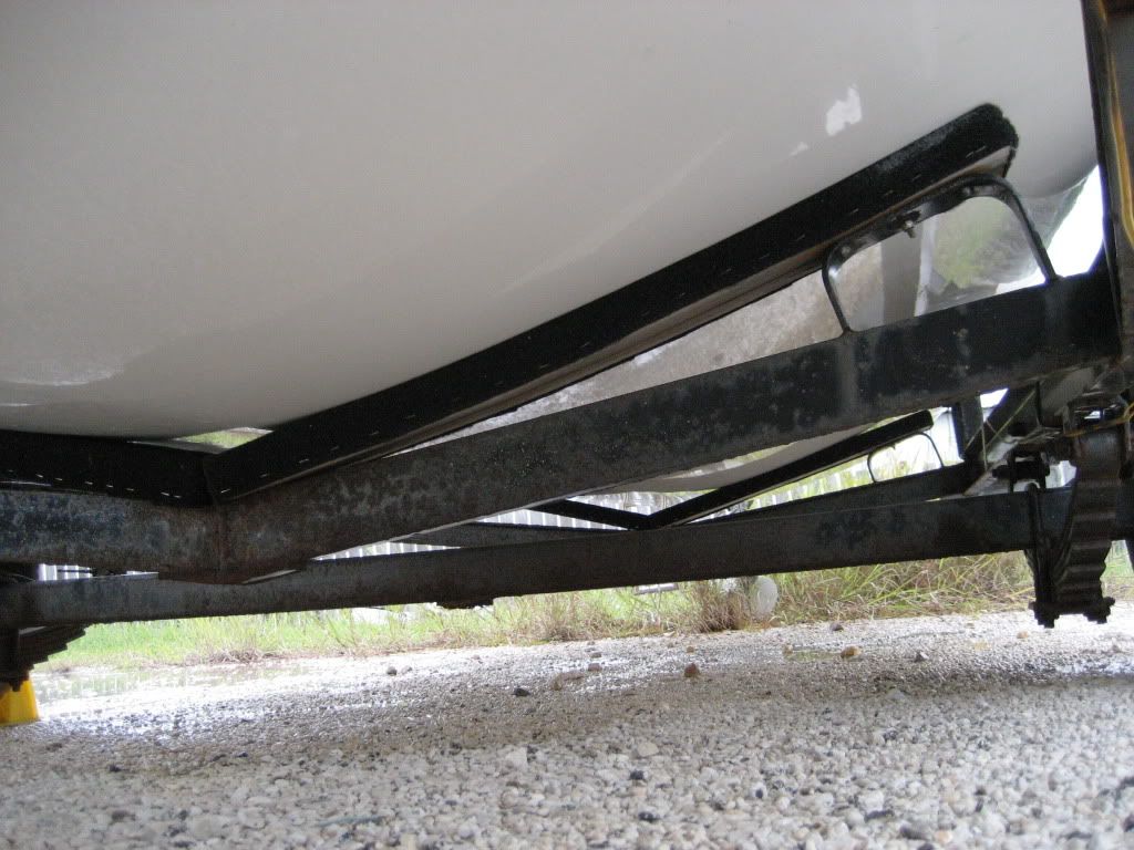

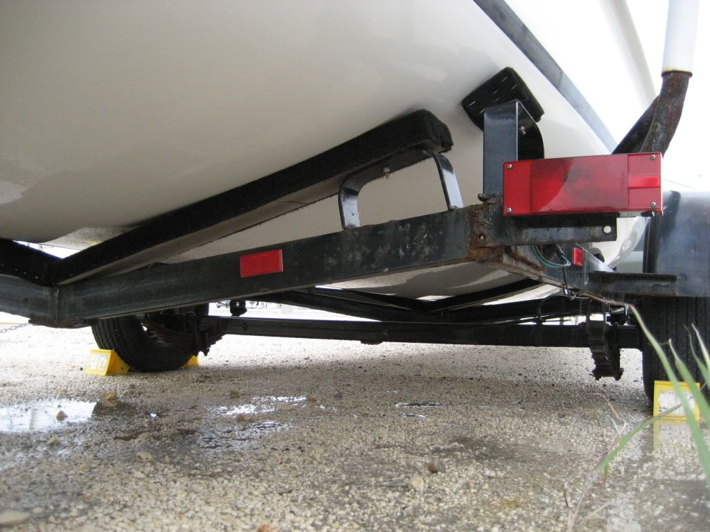

I too had rust problems boating only in saltwater. My stock Mac trailer was toast after about 4 years. So I had a real trailer (all aluminum) custom made which is now about 4 years old. Also the new trailer has sway bars on both axels of the new trailer the boat rides like a dream.
The new alumium tandem axel trailer looks as good today as it did when I bought it. Below is the new trailer.
And below is the stock trailer.
The above pictures really don't show the extent of the rust on the stock trailer, as it was a cloudy day and not too good of of a camera. I've been in the engineering business for over 40 years and this trailer was toast with really bad rust on some of the critical welds and structural members.
I could have taken the boat off the stock trailer and sandblasted the trailer and repainted it and installed new brakes and possibly anodes and then hoped the welds weren't gone while trucking down the road at highway speeds. Then maybe I would have been another statistic and maybe not, but why bother with all that?
I agree with the gentleman above that said the stock trailer was a piece of junk. He said it a little differently, but we both mean the same thing.

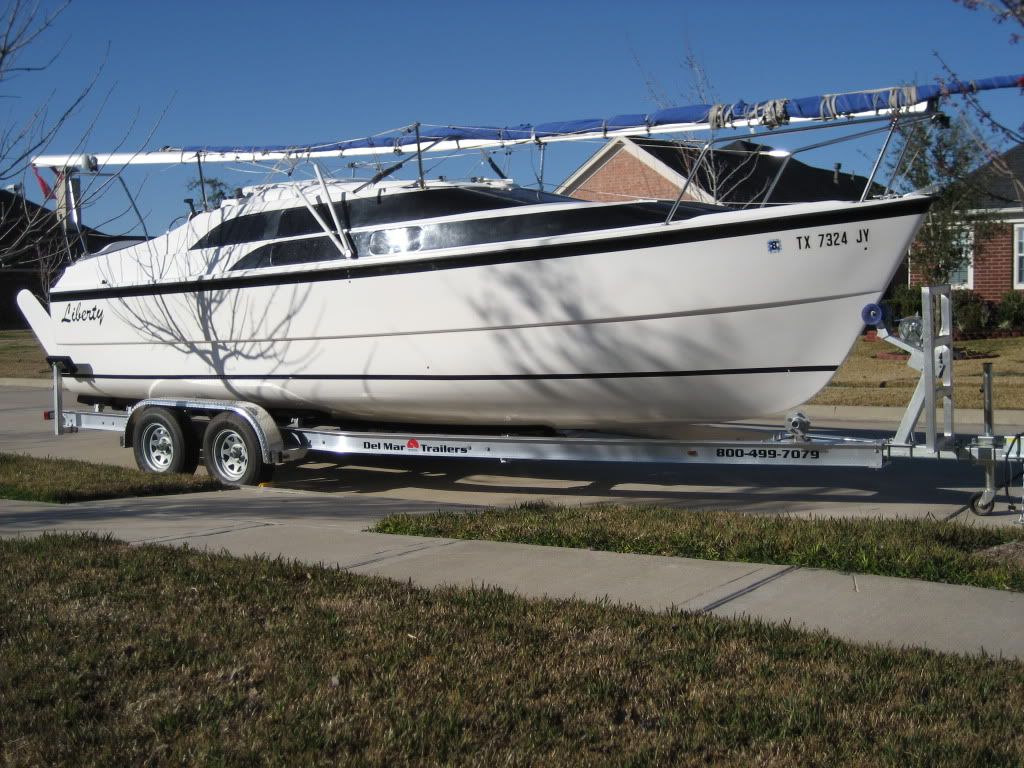

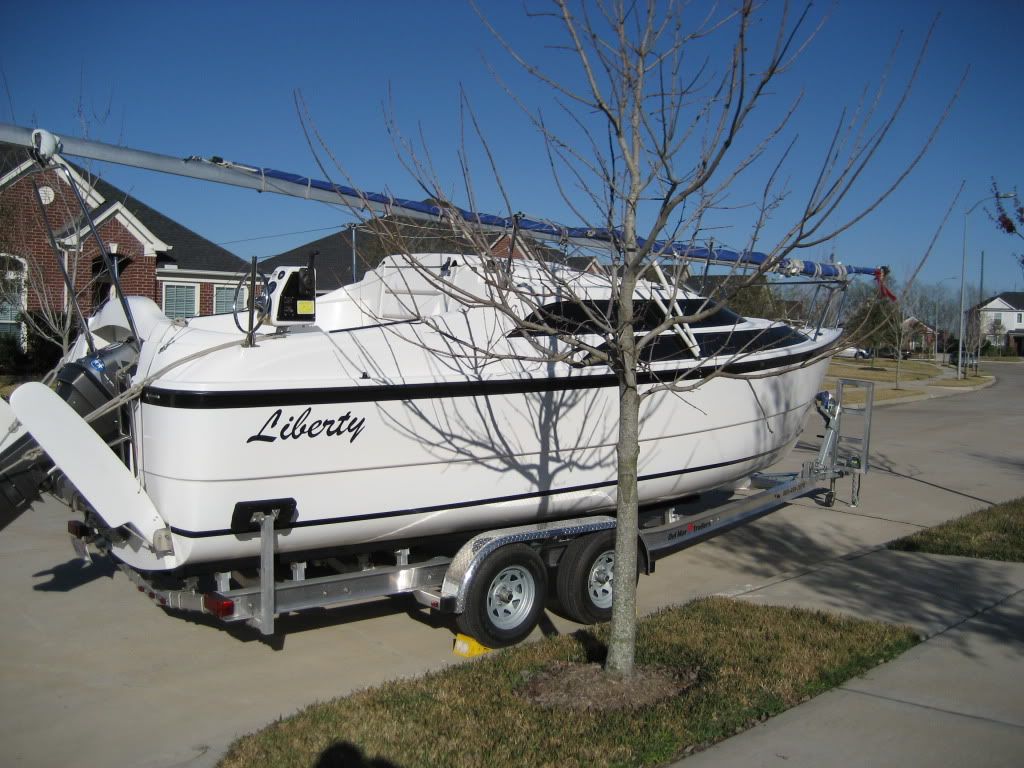

Yes I did and had two options, go with the 8ft.width or the 8.5 width and chose latter. My Boat/ Trailer loaded weighs around 4500lbs for a week of cruising. The Trailer weighs 999lbs. if I went to a 8 ft. beam load would be 4500-5000 lbs.
I chose the wider Trailer as I often have a Stearn wave 2-3 ft. on the open water of the ramp and gives me room so no damage to boat launching or retrieving and have 2 inches leeway each side on my stern PVC guide post.
My bunk boards are enough to carry 3 times the weight of my mac.X.
After almost 3 years Trailering I wouldn't change a thing.
I was offered a $100 adjustment once the boat was on the trailer but that's easy to do.
I also can launch in less water than stock Mac.M trailer.
If your State requires max. beam of 8 ft. one can also do this, just requires more aligiment with trailer and supports and still have 5000 tow.

Dave Bottom 2 pics I believe are his Old Trailer..Appears there is No overhang on the new trailer.. That New one is no doubt very nice .. how about a price on that / those units?? $$$$

I have done many reports and pricing for new Tandem for a Mac.X.
Do a search on DaveB and it will come up.The new MacM trailer just doesn't have tongue length, tandem Axel for us to launch in thin waters here in SW Florida. I launch with my rear tires 5-6 ft. away from low tide in ramps and have a 2 speed winch that shows water 8 inches below the fender when pulling out, I could haul out with 12 inches below fender.
Click on pictures to zoom in.
These pictures were in 2008, if you want underneath supports will post them. Basic supports are Southern Yellow pine pressure treated 4x10 that is 12 ft. long and go past trailer to 2 ft. short of transom. Solid support on hull at least 6 ft on both sides and the 4x10 can carry Min. 3 times the weight of a Mac.
The axels are also seperate with a axel pivit point between the two leaf springs. this alows the trailer to hit a pot hole on one tire and releave pressure on that axel to the other makeing a smooth ride even over rough roads.
Each of my tires are rated 1785 lbs. think thats almost the same as the single axel trailer.
Notice the roller at the bow trailer, thats the bump, most Mac. owners with original trailer refer to. This roller does it automatic.
