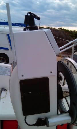

Sorry, Tanstaafl is closed up for the winter so the best photo I have is of the back side of the arrangement I made. I used a plastic cutting board and attached it to the pedestal front, leaving the existing instruments. The extra room gave me a place for the control unit (the round black unit on the right) and a mount for my handheld GPS. I've since replaced the handheld with a chart plotter mounted to the top of the pedestal. The added material is low enough it doesn't interfere with sight lines (the picture is misleading, Josh is only 9 here). I also used a piece to create a mounting point for the drive unit (just below Josh's hand), since it would not fit into the bottom of the pedestal cleanly.

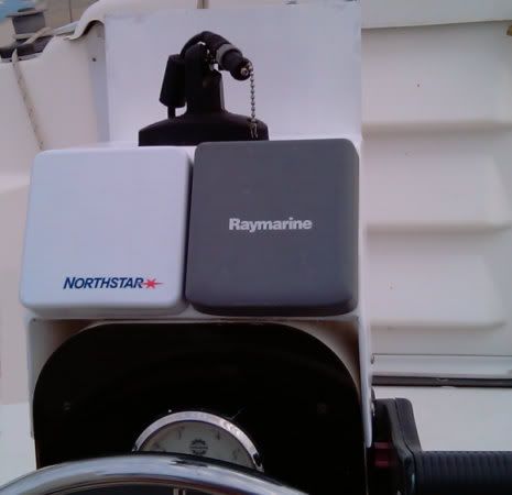

I have installed/mounted a cutting board on top of my pedastal. To the cutting board I have mounted my Chartplotter and a "box" I built to hold the control head for my S1.
The "box" is angled so that it can be viewed more easily from the Captain's Seat. It is made out of a 1/4" pressed wood type of product and spray painted white.
I did not want to drill such a large hole in the top of my pedastal so the hole is in the "box" and the box is mounted to the cutting board with small screws. The only holes in my pedastal are a 1" hole to route the S1 cable, a 1/2" hole for my chartplotter cables and two small holes that allow me to bolt the cutting board to the pedastal.
Got the idea from somebody here around 4 years ago...it was one of my very first mods and I have been very happy with it.
This photo is version 1. I made a newer version that is almost 1" shorter. Makes viewing the Chartplotter a little easier.

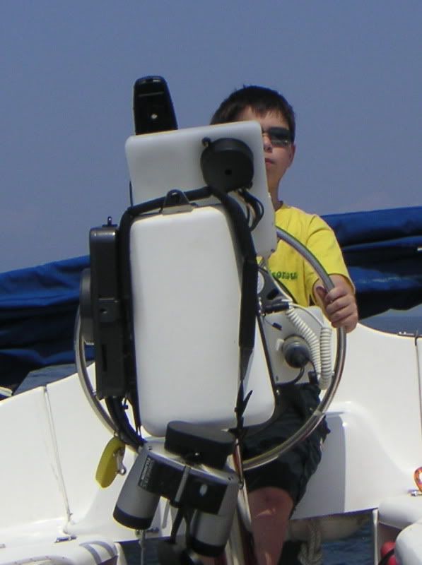

I also made a 'navigation module' box out of marine ply. The box is slightly tapered to fit the pedestal profile and the face is angled to take to make the autopilot and fuel flow gauges more readable. My Seiwa chartplotter/depth sounder is mounted on top of the box so that it can be rotated for easy viewing from either side of the cockpit and a removable backing plate extends up far enough to protect the Seiwa's connection cable. The module sides are extended down the sides pedestal and are screwed into the fibreglass.
