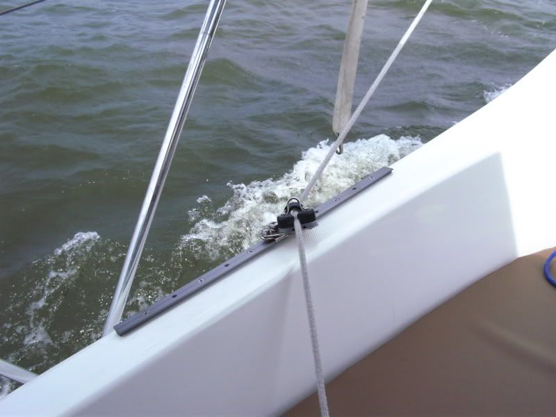

I also discovered today that I need to move the traveler from side to side in order to avoid interfering with the genoa sheet and the winch. This will also keep the traveler from rubbing against the safety line (I think). I also noticed that with the boom extended out to the side that the main presses against the shrouds, deforming the sail. Is this typical? Do I need to bring the sail in?

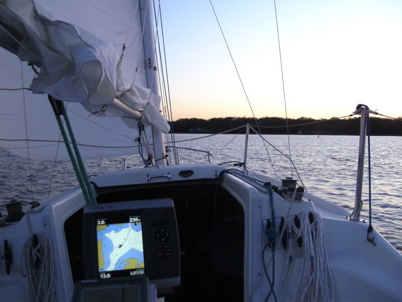

I have two horn cleats on the port side of the companionway and three on the starboard side. This gives me a place to secure/store my halyard, furling line, dagger board line (starboard side) and reefing line (port side).
As for the Genoa sheets I use the Cam Cleats to control my Genoa sheets...I don't use the winches.
For the working sheet I let the line lay on the seat. For the lazy sheet I will coil it up and hang it off the aft cleats.
Normally the main sheet will also sit on the seat if I am using it a lot.
Just another option.

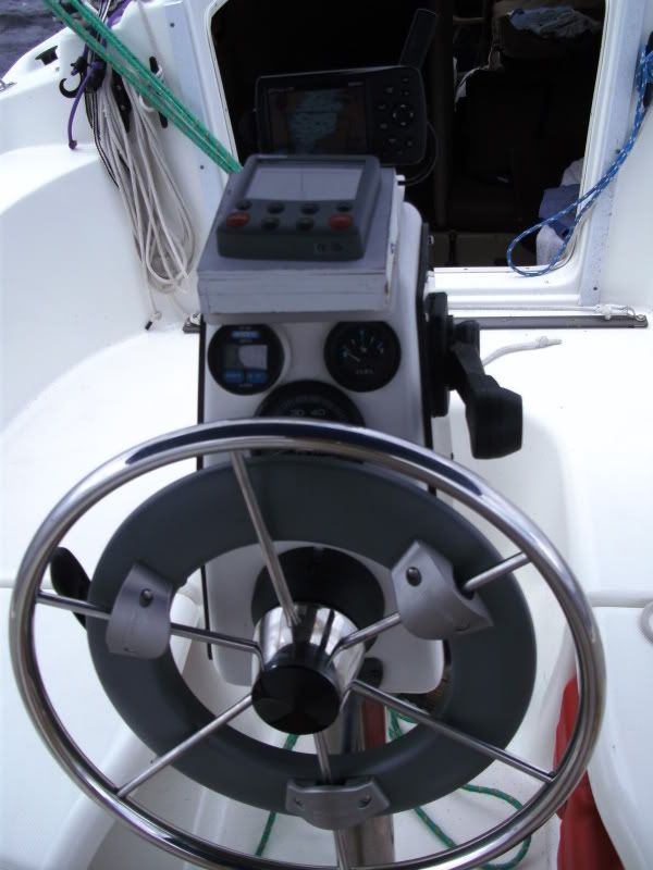

In the cockpit, coil the Main sheet up and drop it on the floor of the cockpit and typically I hand it over the shifter handle on the pedestal for a quick grab, if needed as I am relaxing. The Genoa sheets are each coiled and laid out on the cockpit seats on each side. This keeps it all nice and neat with nothing messing our favored back rests forward in the cabin.

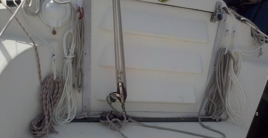

I got tired of the rat's nest of lines, especially after bringing all lines aft.
So first I made some hooks with rope loops attached to hang all my lines from. Much like these from Ronstan and available at WestMarine, except I just got some 3M adhesive hooks from Home Depot and made the loops out of 1/4 inch nylon and sewed the ends together:
Then I coiled the five lines in my cockpit and hung them from the loops:
On the left side are: Jib Furl line, Main Reefing Line, and Topping lift. Right side are the Main Sheet, and the main halyard loop. I just coil the jib sheets up and lay them on top of the winches.
Then I got my lablemaker and made labels for the various lines and control points. The picture below is of the right side and not that good, but you get the idea:
I find that my guests appreciate seeing different lines and controls lableled. It makes it a lot easier when I have someone not familar with sailing, to enable them to help me with the sailing chores. Also, I have a Man Overboard Pocedure laminated in the cockpit. and it helps to go over the procedures with people when they can see and identify the variouis control points.

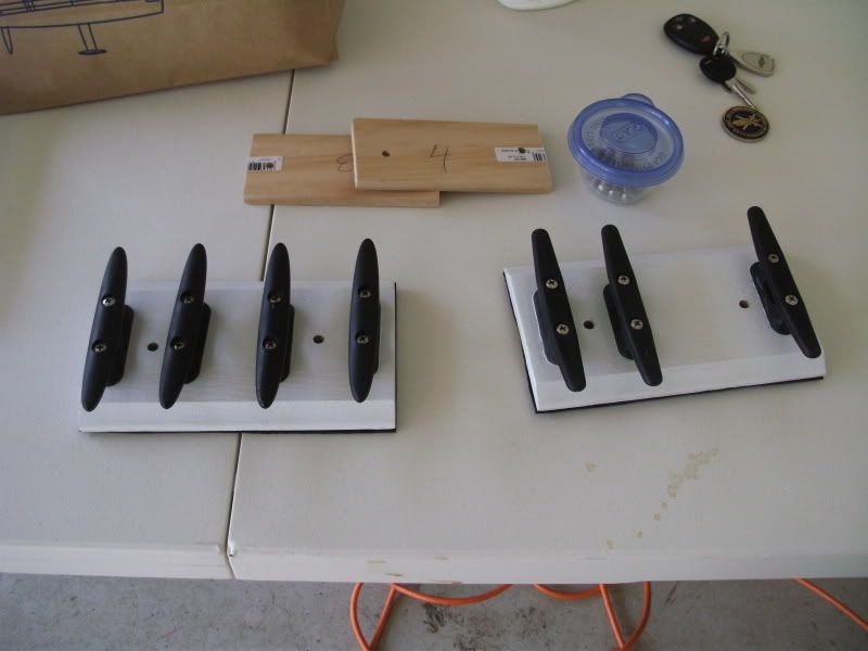

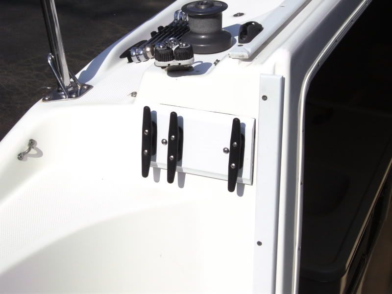

Last year I posted my pictures of my horn cleats at the front of the cockpit...boat came from Original Owner with 2 bolted directly to the fiberglass on each side. That wasn't enough for all my lines led aft so this Spring I built two "cleat mounts" (one with three and one with four horn cleats) and mounted them. They work well for me. This way I can coil and hang my left over bit of halyard (line closest to hatch on starboard), dagger board, spinnaker halyard, spinnaker tack line (next three on starboard) and on Port (single line reef closest to hatch and then furling line). My Genoa sheets and Main sheets do sit on the floor or loosely coiled on the seats while sailing. When motoring I coil these lines and hang them from the cleats as well.
