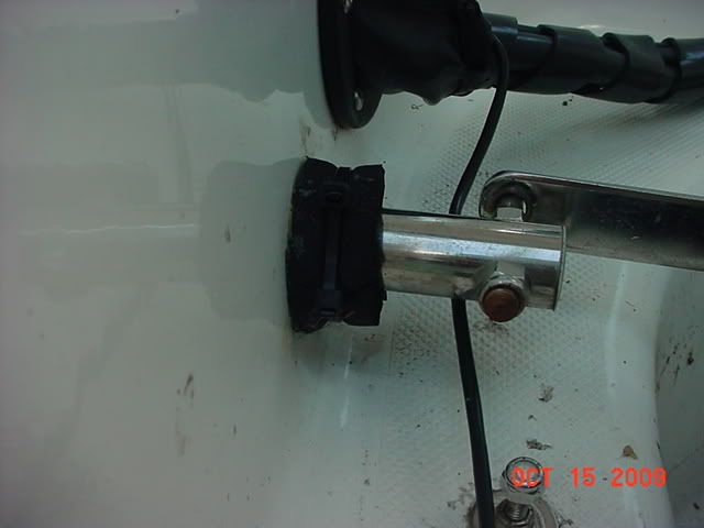

This was an issue with my
I setup a fix for that using pipe insulation and a plastic wire tie.
the finished installation. It is glued to the fiberglass using silicon sealant. Makes it easier to remove and replace as the pipe isulation dries out in the Florida sun.

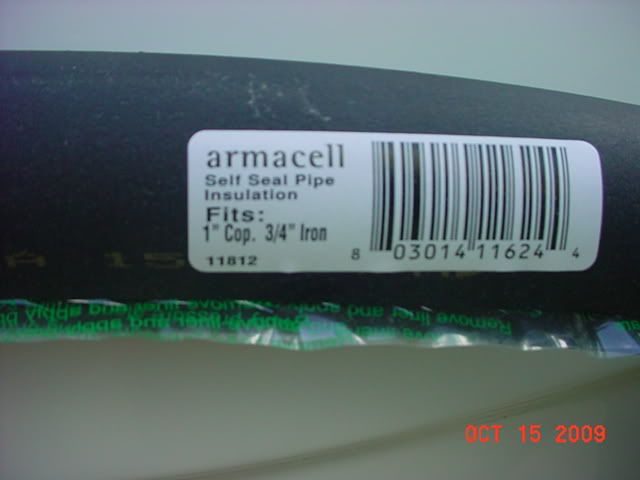

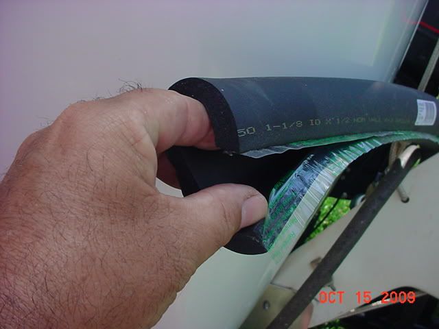

This is the pipe insulation I used. I just cut a short length to use as the seal (as seen above)
The pipe insulation is split so it's a piece-o-cake to install. Just peel off the sticky tape backing and press it together to form a good seal. Then gently pull a plastic wire tie around the seal's midsection like as if it were a trouser belt. Apply only enough pressure to ensure it will make the seal contact with the bar. Any more than this and it may pull the seal away from the fiberglass and you will have to do a do-over. Use a black plastic wire tie since they are color-coded for weather durability. A black one is the most durable in terms of UV and temps.
Finally, like I said ... I have found a swimming pool noodle (available at Walmart) that has a center hole diameter of 1'' inch very suitable for this application. Moreover it is designed out of a material that withstands water and extreme sun exposure. It is not split like the pipe isulation, so if you do not want to slit the noodle to slip it over the steering bar, just remove the link pin on the end and simply slip the noodle seal in place.
