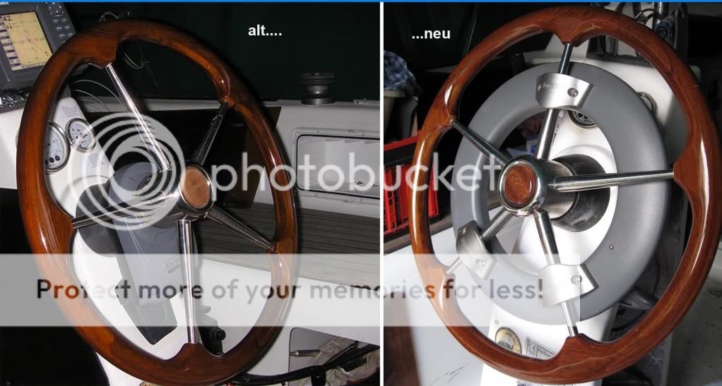

..I was a victim, that what it looked like:
I lost my friend when I was sailing single handed on the Baltic Sea. :(
It took me about one year to get my substitude. I changed to the SPX Wheel Pilot. Here are both installations.
Comparing both:
The big advantage of the Sport Pilot was: engagement by one press on the controller, no mechanical clutch to be operated, it was looking better :)
The disadvantage: Space between the steering seat and the wheel was decresed by about 4 inches, aditional play of the steering around the vertical axis
As long it was working I was very pleased with the SP X 5 Sport Piƶot.
