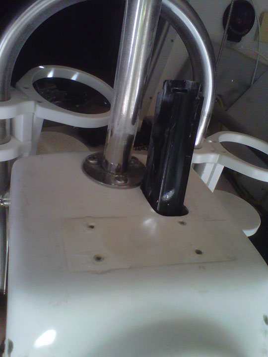

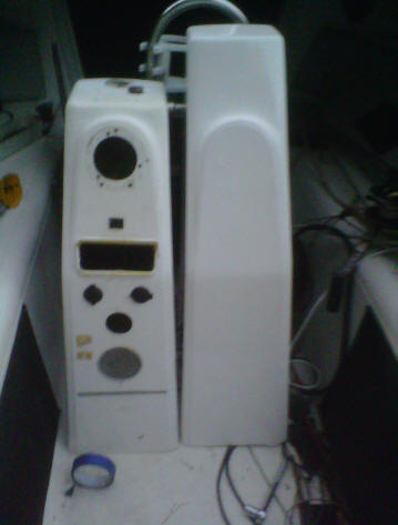

1. This will not work on a rotary steering system, must be rack and pinion.
2. A rack and pinion steering system will not fit into any pre 1999 MacGregor Pedestal. (unless you want to drill a hole at the top of your pedestal... see my attempt below)
3. You can get a new taller pedestal from Blue Water Yachts for $295 + shipping. http://bwyachts.com
and your side panels will still fit on the new pedestal.
