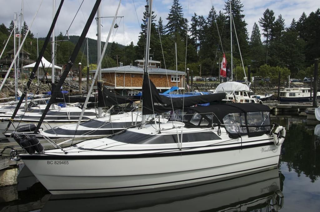

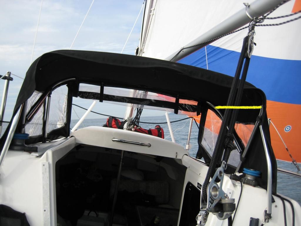

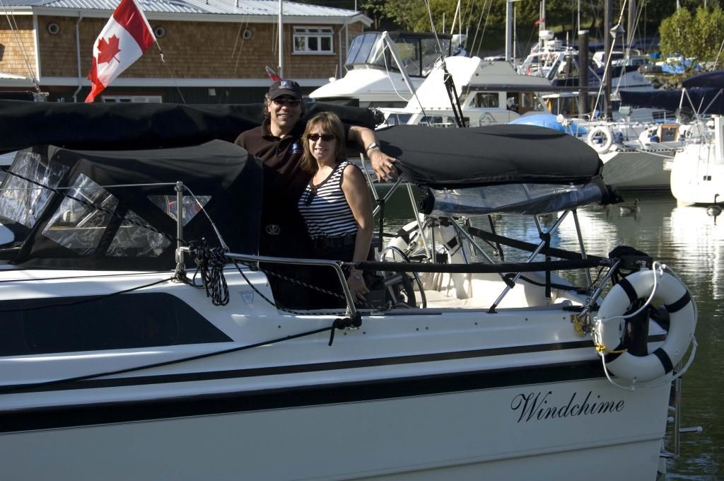

Our boom clears our dodger and bimini with the boom mounted in the factory height position with a standard size main sail.
We have the standard BWY wide dodger, with a custom bimini and full enclosure that matches the dodger height.
We can sail with this configuration by removing the connector piece between the bimini and dodger, and removing the front side panels.
There is not a lot of clearance but the boom never rubs on dodger or bimini, the boomkicker helps with this as well.

Nice Pictures, whats the year of your MacX ? I think Rodger raised the gooseneck and maybe the Leech after 1999.
Think Dimitri can chum in on this as his 2000 MacX has a lot more bimini clearance than mine.
[quote="Wind Chime"]Our boom clears our dodger and bimini with the boom mounted in the factory height position with a standard size main sail.
Wind Chime
Posts: 866
Re: Bimini and boom clearance
Post by Wind Chime »
Thanks Dave,
Ours is a 2000X.
We bought the 2000 specifically because it had some changes released that year. Most notably for us was the change from a plastic companion way step (with ballast vent hole inside) to a solid stainless steel and wood three-stair ladder, as well as more efficient rudder design and stainless steel brackets. I can not comment on whether the gooseneck is higher or not.
