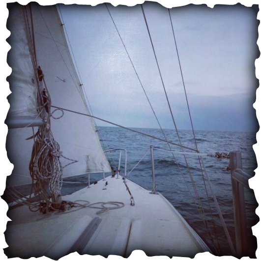

AbuSiyam
- Posts: 11
- Joined: Sun Jan 05, 2014 12:46 am
- Location: Kingdom Of Bahrain
Re: rigging Mac 26 (1993)
This is how it looks like
