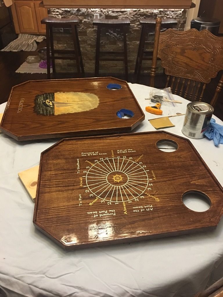

After the first season, I replaced the cheap plastic table top( which had little room for meals and was slick) with a larger Oak table top. We really enjoy this added meal room and atmospheric warmth. I've created a few of these tops now and there is one sailing on the Mexican coast right now and another boxed up and in the mail on it's way to Western Autralia to be a part of the 26M Wanderer's cockpit!
Anyway, a cockpit table is definitely a worthwhile mod and the one BWY has is set up for easy removal of the table for sailing room...

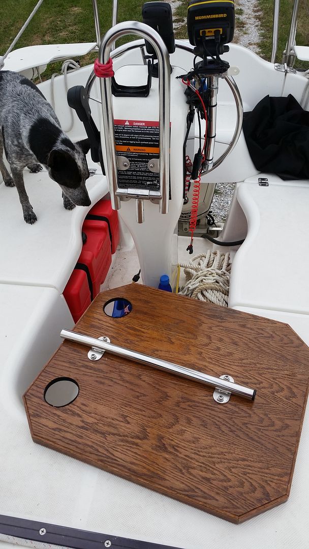

Here is a picture from a couple years ago that shows the mount with the table removed. (it takes 5 seconds to remove or install the table) You can see the mount on the pedestal in saililng position. There are two pins. You rotate the little T-mount up horizontal and pin it in place, then slide the table onto it and pin the table in place. (note, this is my old table. The current ones are about 2" shorter fore/aft and about 1 1/2" narrower for more leg room.
I can also provide additional pictures if interested. <insert Gratuitous self promoting plug> You can see ours on our videos. This one starts out, showing the older, larger cockpit table. --> https://www.youtube.com/watch?v=CfZXw1c ... 49paWcIOMv

Your mod to original BWY table looks great! Thank you for the idea! I am ordering one now for sure.

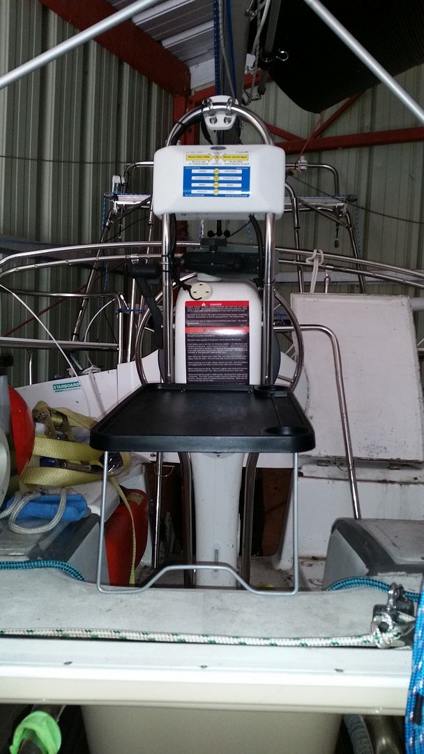

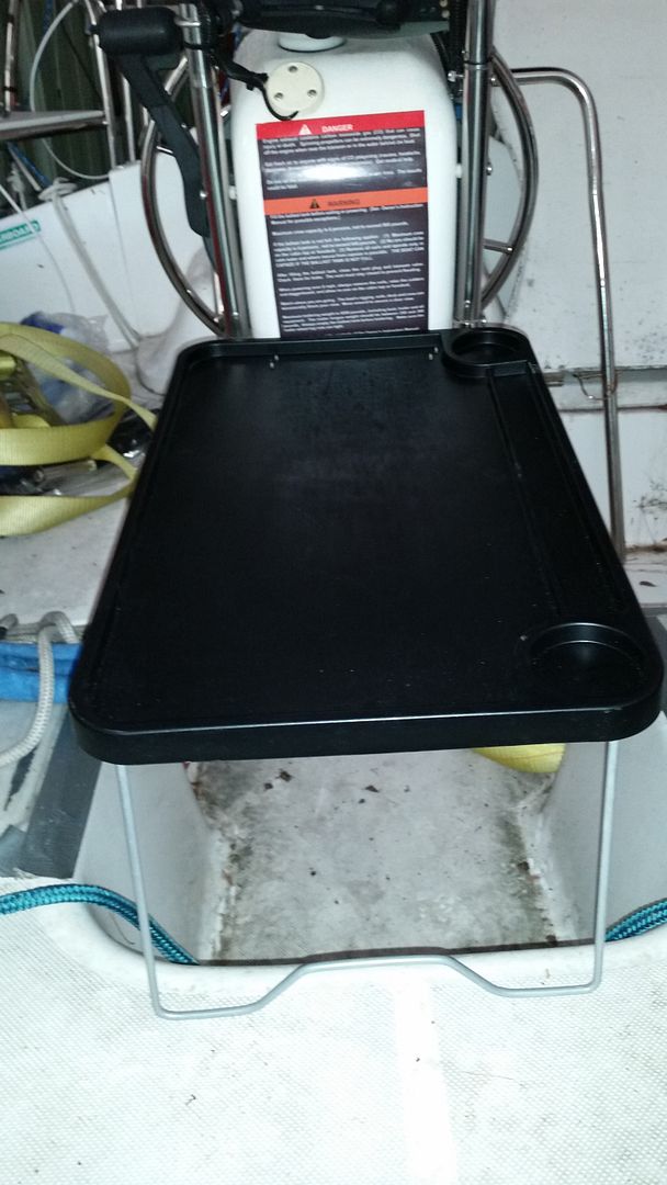

Here,s my $7 cockpit table
http://i844.photobucket.com/albums/ab1/ ... tmiprx.jpg
http://i844.photobucket.com/albums/ab1/ ... y9ck1c.jpg
http://i844.photobucket.com/albums/ab1/ ... teyrj1.jpg
If u just use one spring clip u can have the table off center to either side for more room when only one person is using it

Russ, Quite a bit larger. Of course, I am drawing a blank at the moment. I'll measure when I'm at home. and post. I'm cutting out another one tonight!RussMT wrote:Hey Doug,
