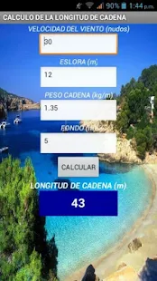

Also, I found a great Android App called "Calculate anchor line lenght" ( https://goo.gl/TT7DAl ). It looks good but it's all in Spanish and there is one required parameter "Fondo" (Background) I do not understand?
"Fondo marino" means "seabed" in Spanish. So I imagine that could be the choice for seabed type. A few likely options might be "arena" [= sand] or "arenosa" [= sandy], "roca" or "piedra" [= rock] or "rocoso" [= rocky], "barro" [= mud] or "fangoso" [= muddy]...
Lamentablemente, mi ornitorrinco sufre estreñimiento, así que no puedo ser más útil.
Re: Which Chain?
Posted: Thu Feb 16, 2017 4:48 am
by Neo
Bilgemaster wrote:"Fondo marino" means "seabed" in Spanish.
Thanks ....
The application does not accept characters in that field but here's my best guess translation....
VELOCIDAD DEL VIENTO = WIND SPEED
ESLORA = LENGTH (OF BOAT)
PESO CADENA = CHAIN WEIGHT
FONDO = DEPTH (TO SEABED)
LONGITUD DE CADENA = CALCULATED CHAIN LENGTH
The calculator (with the parameters above) really highlights how import it is to use a heavier chain.
Thanks for your help guys :)
