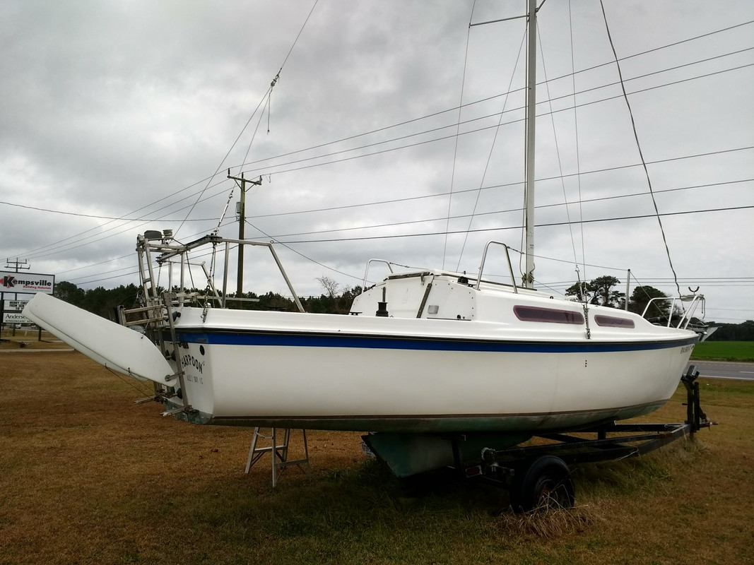

Greetings all! Dennis in central VA here. I picked up a 1987 Mac25 from the Outer Banks a few years ago on a whim. Every spring I feel the urge for adventure and thoughts turn to sailing and exploring the Chesapeake. And each spring I've only managed to get the boat through a thorough pressure washing before I get distracted or demotivated for one reason or another. But this year is different! So I'll start with this post.
Most of my sailing experiences have been on Hobie cats and their sailing kayak/trimaran, on the sound-side of the OBX. I sold those to focus on the Mac25 last fall. I know the basics of sail and am constantly learning, but the prospect of prepping the Mac25 is still daunting.
As for the title of this post: a previous owner had replaced the stern railing with a custom-made framework that includes dual-rudders, a Harken car & track traveler system that spans the top of the rail, and a motor mount that can be raised and lowered via an integrated winch. I am having trouble uploading images at the moment, so hopefully the following Google Photos link will work: https://photos.app.goo.gl/EtctDXDXdrH4vKvq6

I hope you get sailing this year. I hear the 25 is a sweet-sailing ride. I don't know it well enough to give much advice, tho. The way that boat sits on the trailer always makes me do a double-take. It's normal and they're all like that, but it looks totally bizarre.
I also don't know the Chesapeake at all so I can't contribute much there either. A 5HP would handle any conditions I have ever found myself in, but I'm on inland lakes and rivers. But if your tides and currents are less than 3 knots, I wouldn't hesitate to try my luck on that Bay with the 5HP.
Anchor discussions aren't easy. The answer is: it depends on when/why/what you are doing when you anchor. It's hard to make out what you have on the bow roller there, but it looks reasonably beefy. In my opinion anything in the 10 to 20 lb range would do fine for that boat under "normal" conditions. Everyone's normal is different, of course. And it's hugely dependent on the bottom that you are trying to hook your anchor into. Mud and sand are great, weed and rocks are not. Wind protection good, high winds bad. Calm good, waves bad. Alone good, neighbors bad. Chain good, rope less good. 5th Gen Mantus good, imported Danforth knock-off with a fake label bad (but still probably fine for a 25). If you plan to anchor for long periods with tide, wind and current swings, then you need an anchor that will re-set easily, like a Mantus or Rocna or any of the latest generation of self-righting, re-setting anchors.
The coast guard publishes the legal minimum requirements for safety equipment, but if you want to go actual bare minimum (laws be darned) then you need a personal-floatation-device and a floating hand-held VHF securely strapped to your person. Better if it's GPS enabled with an SOS button.
No idea on the electrical box...need more info, photos, etc. Wait, you have a WINDLASS? What the h... Luxury! Sounds like the P.O. may have been physically challenged in some way, to require the windlass and motor raising system. Not sure what your physical state is, but most of us 25 and 26 owners just pull the anchor and hoist the motor manually.
Good luck.

The quality of the work does look good. Will take some elbow grease, but that's part of the fun, isn't it?

The boat doesn't need to sit that high on the trailer. I'd be willing to bet it's a trailer from a different boat. The 25 I had years ago sat like that and made if very difficult to get into the water. I made some measurements and shortened the uprights over the summer while it was in the slip and made it easy to load and unload. Welding skills were required.

Did you have the original axle? On my 25 with the original trailer, it seems like the limiting factor would be the keel hitting the center of the axle. In it’s current (almost certainly original) form, there’s only a few inches between the axle and keel for suspension travel. I feel like not having more of a ‘trunk’ for the keel to retract into was kind of a miss on the design of the 25.beechkingd wrote: ↑Sat Feb 26, 2022 9:42 am The boat doesn't need to sit that high on the trailer. I'd be willing to bet it's a trailer from a different boat. The 25 I had year ago sat like that and made if very difficult to get into the water. I made some measurements and shortened the uprights over the summer while it was in the slip and made it easy to load and unload. Welding skills were required.
Looks like the OP’s axel has already been modified with a dropped section in the center, may give some more room for lowering, if it hasn’t been done already.

That custom work looks so interesting and professional. However, it also looks complicated.
I see a fuel line coming out the transom. Where is the fuel tank? I hope the compartment is vented properly.

Gotta say, thats a heck of a set up the prior owner built. Looks neat!
