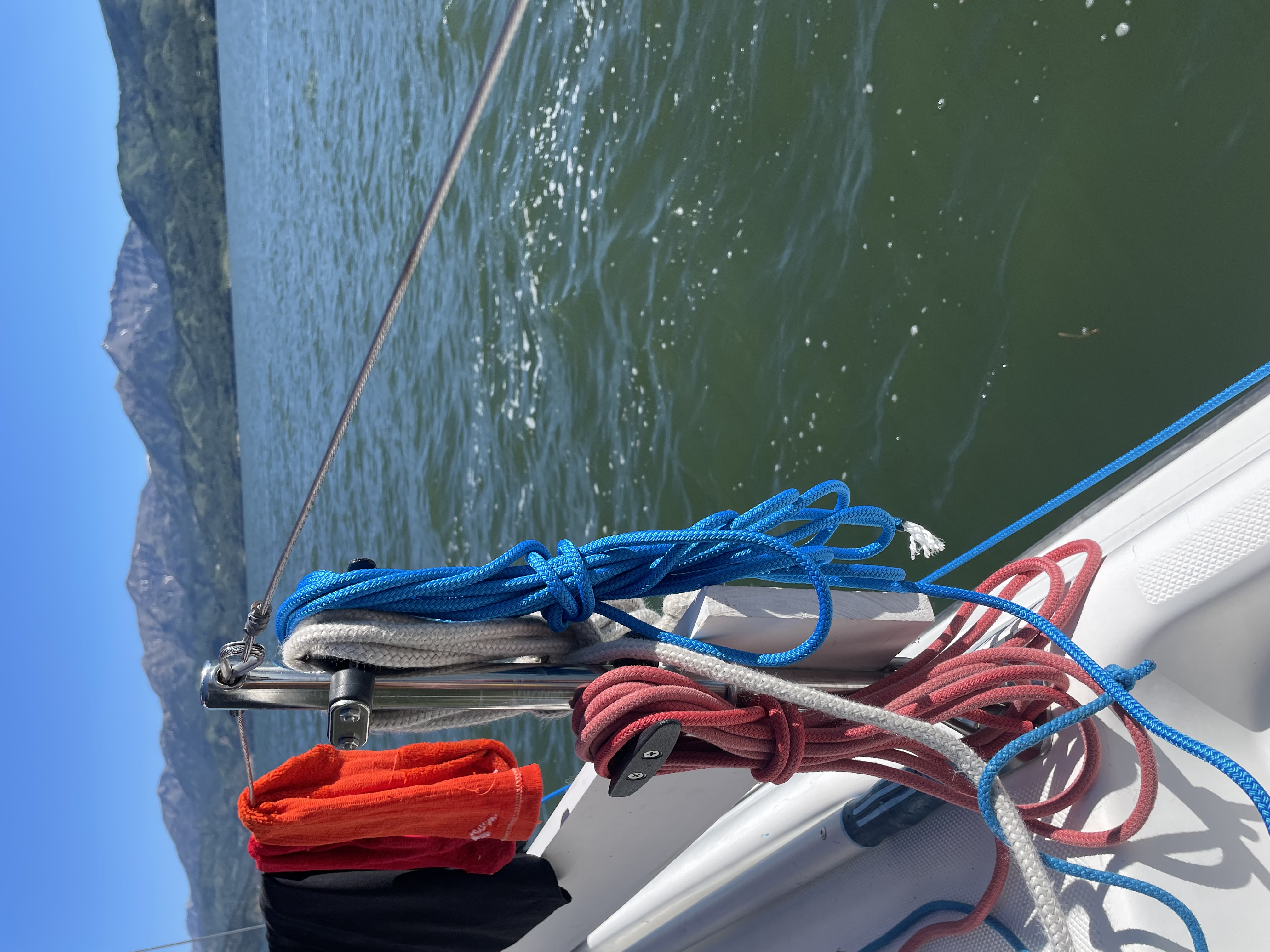

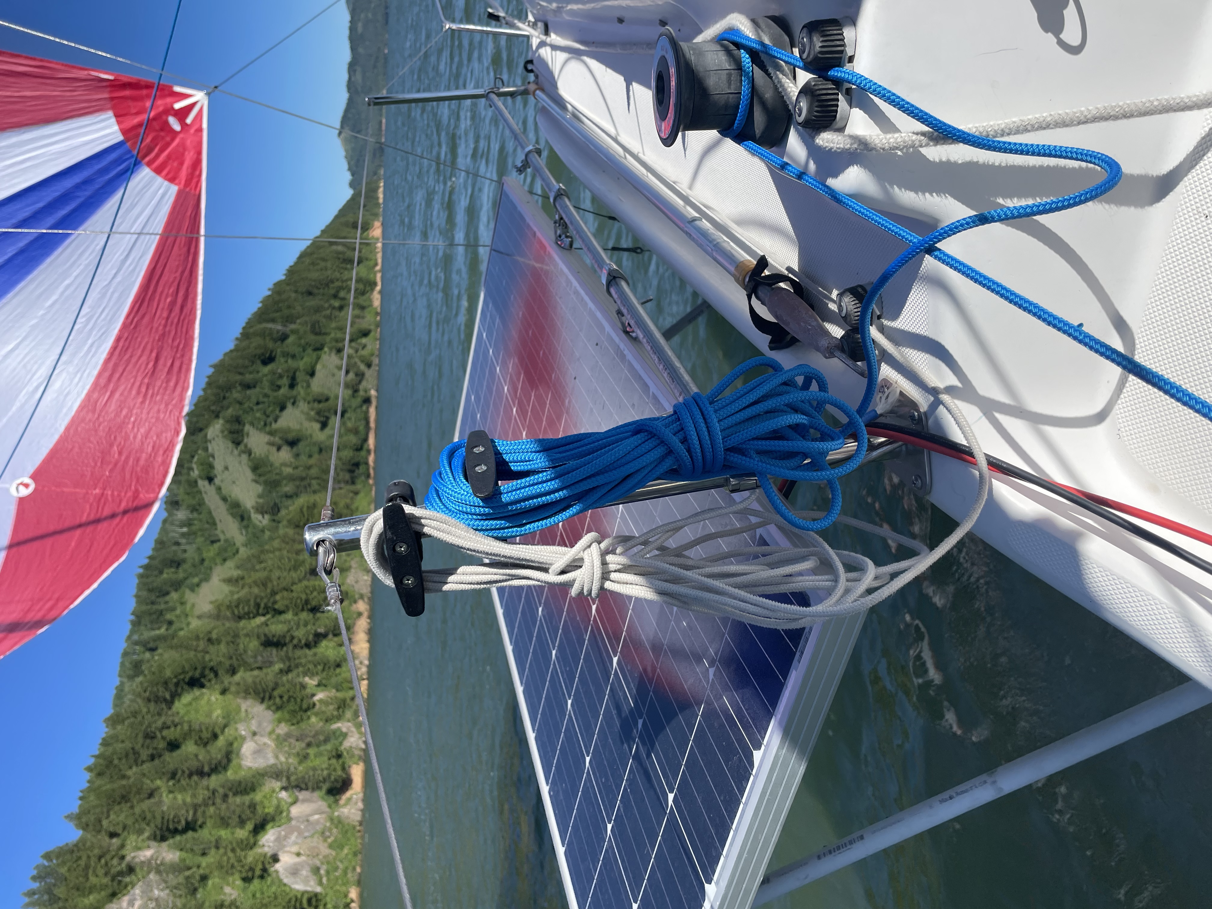

I really like these $12 cleats that I put on my lifeline stantions:
I use them to hang jib sheets, halyard, spinnaker sheets, roller furler line etc on to keep them out of the way.
Here an Amazon link if you're interested:
https://amzn.to/3RHv7AW

Ha, also in that last picture above laying on the deck you can see my DIY whisker pole for sailing wing on wing, which can go in this category too. It's an old painters pole with a sawed-off paint roller screwed on then end so that it has a "spike". You put that end in the eyelet of the jib sail where the sheets tie on and then on the other end there is an epoxied-on little grabber deal that grabs a plastic padeye that screws to the mast.
(The more "legit" way to go for this is https://shop.bwyachts.com/product-p/3813-1v4.htm)
This mod was basically free from old junk, but I did pay a few dollars to BWY for the padeye brackets for the mast. I also use those padeye brackets as a place to clip my lazyjack lines when not in use, and they work nicely for that.

Hi LordElsinore!
Love your “Solar Wings” idea!
Nice arrangement and locating for ease of adjustment and cleaning!
Rather brilliant and elegant!

Thanks! I stole the idea from the boat on the "Sailing Millenium Falcon" YouTube channel. They have a solar panel out each side like that. For the last two years I've had that big 200 watt panel hanging off the back attached to the mast support with some additional SS struts coming up from the stern seats. But I haven't liked the stress it puts on the mast support or the fact that I had to keep telling people not to use those extra supports as grab handles getting in the boat.
I'm still experimenting with it coming off the side like that, but so far after 4 or 5 sailing trips with them like that it seems a lot better. I'm temporarily using a galvanized electrical conduit pipe to connected to the lifeline stanchions with bimini parts, and PVC pipe with rubber feet to support from underneath from the gunnel, but I have plans this weekend to replace with a nice solid stainless steel tube that got delivered yesterday.
It feels a lot more sturdy than when it was hanging off the back, especially if I leave it connected and folded down while towing for a short distance, and lots easier to remove when towing long distance than it was when it was mounted up higher.
My only concern is how it will handle 20 degree+ heels, very heavy wind, etc. Folding down should be fine for wind. Might need to figure out a way to secure it up or down for big heel. Clamps holding it up to the lifeline will probably be my first answer for that.
