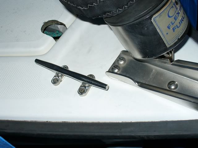

Well that is what I started to do yesterday and I will finish it today. What a job and I was a bit nervous cutting big holes in the boat even above the water line. I mounted it to the Port side of the Forward Hatch. Ran it thru a 20 amp ground fault and back to the stern where it will branch out to who knows what yet . . . . a couple more outlets one for A/C and a couple of switches for lights ?????? I am going to install a separate charger inlet for when its in the Drive and I can just use a common extension cord . That will require the install of a switch as well so that the separate outlet isn't hot when I plug into shore power. I am thinking I will use switches with indicator lights for that .

I mounted my twist lok 20 amp receptacle in the front of the anchor locker. Drill the proper sized hole, then fish a chunk of 12 ga. flexible cable back to your power panel. I used a 20 amp breaker, followed by a ground fault receptacle. Most of the time you nose the boat into the slip, why run cord back that everyone will trip on? Just use a rat tailed file to cut a semi-circle into the edge of the anchr locker door, so you don't pinch the cable...
