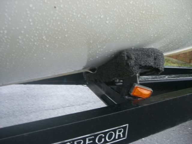

Posted: Sat Dec 22, 2007 6:48 am
by Greg
I installed a keelshield on my X in 2004. This summer part of it came loose when I did the mac bump and the winch strap wasn't loose. As others have said, be sure the winch strap is loose when you do the bump- especially if you install a keel guard or shield.

I don't understand why that strap being loose would make a difference. I am looking at my boat as I write and where the Guard would be is no where touching anything?? I went out and looked real close and the above is not actually the case but it appears if I were to cut the first 2 inches off the V bunk support on each side, I would have complete clearance.( at the center where it makes a V)
I have also sprayed my bunks with silicon weather proof spray lubricant and I no longer need to do the bump....believe it or not I can now easily crank my boat all the way to the sweat spot.
Posted: Sun Dec 23, 2007 1:36 pm
by Greg
When the strap is tight, it pulls down on the bow.
The boat didn't move forward all the way on the bump and the guard peeled loose from the force.
I didn't lube the bunks which would have helped and may have prevented the problem.
Also notice the guard has yellowed. It was white when new and practically unnoticeable.
