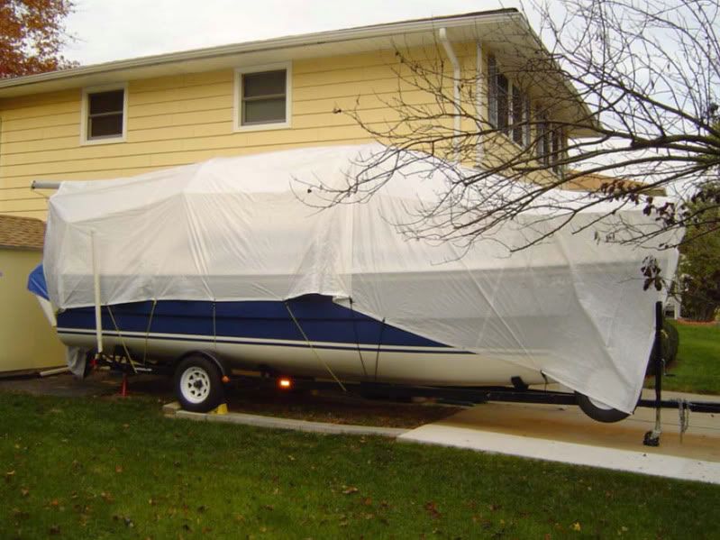

I fabricated a tarp support "ribcage" last year for our
's first winter, and it worked just fine. Blue Heaven was just pulled for the season on Tuesday so is still without a cover at this point - hence no photos to share.
I used 10' sections of grey plastic electrical conduit (not truly PVC, I believe), secured to the base of the stanchions with zip ties on each side of the boat. They took the bend ok without breaking. I then tied them together with a longitudinal ridge pole of the same material -- creating a "covered wagon" sort of frame that stands well above the mast. Forward of the front stanchions the ridge pole incorporates a 45 degree bend (a standard conduit connector piece) downward so that it meets the mast about mid-way along the pulpit. Then I covered it with a 15'x30' white tarp. I do put rubber caps over the tops of the stanchions to help avoid tarp punctures.
The end result is a package that is laced together at the bow but open at the stern (closed off with a small vertical tarp that drapes over the rudders and the outboard motor). The snow slides off, and it is easy to board via the stern ladder to enter the cabin or even crawl forward above the cabin if desired. The white tarp transmits plenty of light for daytime visibility within and does not trap heat like a darker color would.

And thanks for the pics, PH. That's exactly what I was looking for!
