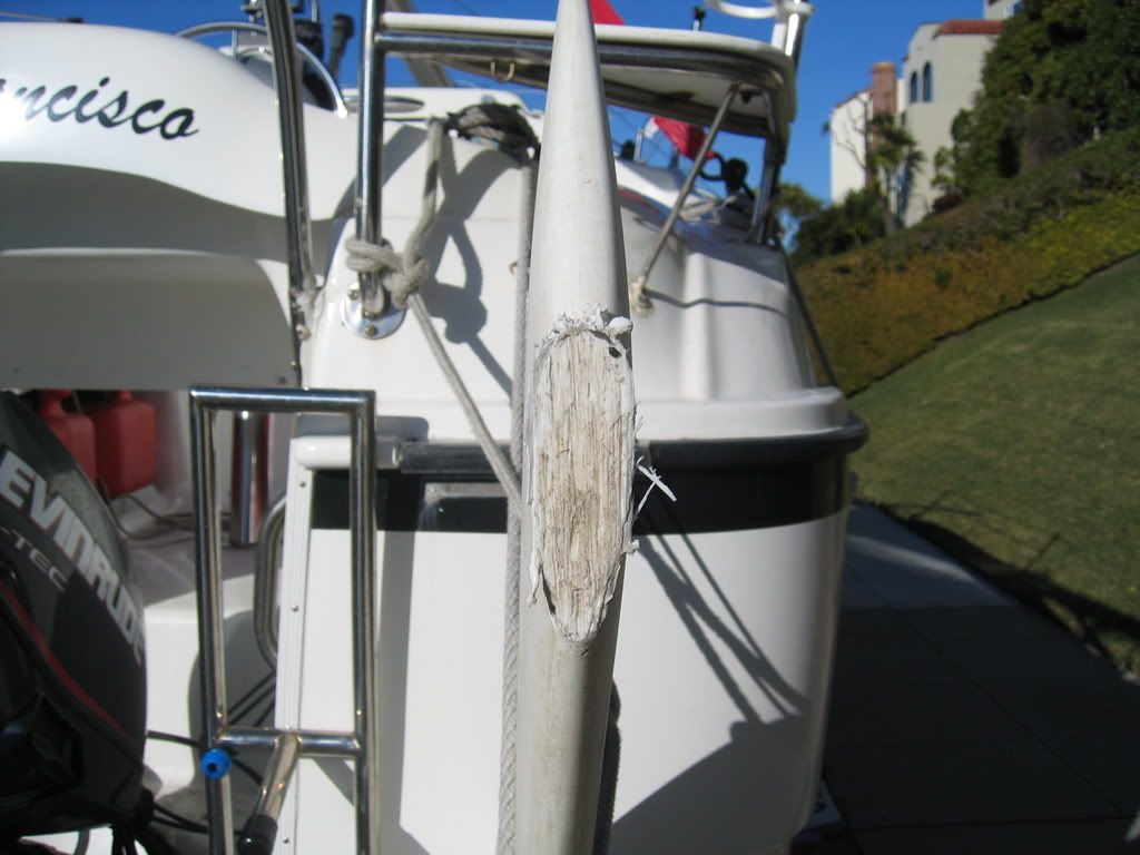

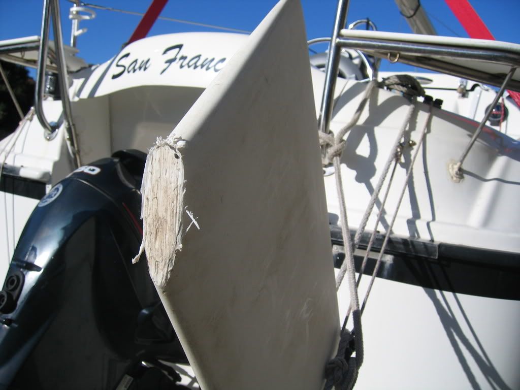

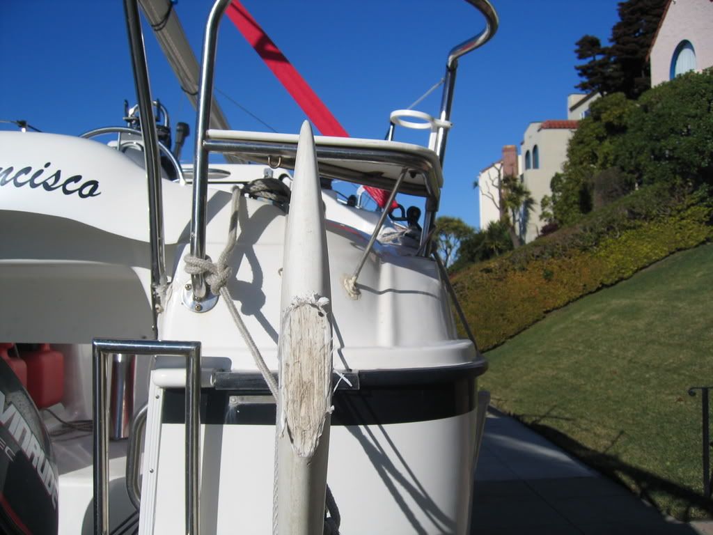

Trailering back from a Christmas trip to Monterey Bay. Rudder line snapped and the starboard rudder met the pavement. Needless to say, ruined. This is a custom IDA rudder which many be irreplaceable :evil: :x :(
Moral of the story... Always secure your rudders with a backup system while trailering.
Leon

Too late. Been there, done that. I didn't grind quite as much off. It is a sickening sound when you hear it happening.

Good news. Talked w/ Joel and a repair can be done.

Your damage looked pretty ugly. I hope your rudder can easily be replaced or repaired.

A repair should not be difficult to do. It looks fairly straight forward. The biggest challenge would seem to be adequately strengthening the repair for the tork it will take in the water.
Since I do a lot of structural furniture repairs in my line of work, I'd be interested in seeing picts of the repair through its varied stages.

My damage was about half of what is in the picture. I used Marine Tex to build up a slightly bigger than needed repair and sanded it down to original size. The Marine Tex bonded well to the exposed fiberglass. I then used polyurethane spray paint to finish things off...........looks great.
I think you may need to build up layers of Marine Tex and allow it to harden for at least 24 hours between each layer until you get the desired shape. Having repaired my rudders quite easily, I feel that your damage iwould be repairable

id be inclined to make up some sort of reinforcing along the lines of drilling and tapping some screws into the rudder,building up the fiberglass and resin before sanding back and finishing with gelcoat

I repaired a Mac 26-S centerboard with similar damage, and it went quite well and was probably stronger than original.

Seems like a pretty straight forward fiberglass repair job to me. Even an idiot like me should be able to handle it. Heck, I'd welcome the opportunity for the experience and practice, much as I do when I hit a golf ball into a bunker. :D
Perhaps as a way of strengthening the repaired area you could drill a couple holes into the exposed area and glue in one or two steel or aluminum rods and then build up around them.
