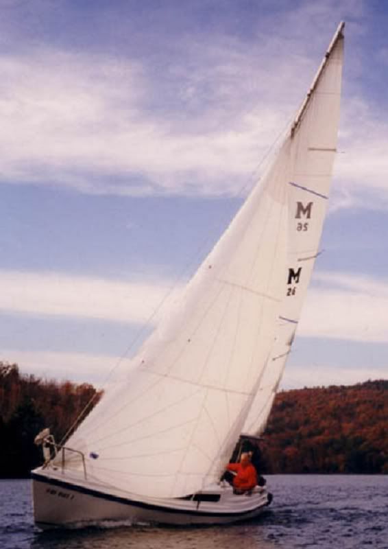

We agree with LOUIS B HOLUB…acknowledge some increased creature comfort with the larger cabin powersailor.
The “pure sailboat” hull design of the 26’S performs very well in sailing competition, day sailing, cruising, and makes hull speed motoring with a small outboard. The 26’S sails faster than it motors.
The powersailor motors three times faster powering than sailing. The motorboat hull design provides better motorboating, and offers a hybrid, marginal, sailing experience.
The High-Freeboard of the powersailor 'magnifies' the quick motion of a light, narrow water ballast design, 'decreasing motion comfort' for sailors in bumpy/rough conditions or on the hook. The powersailor 'High-Freeboard' (more windage) heels over more, makes tacking difficult, and makes the boat wonder at anchor or on a mooring in the wind.
We consider the 26’S lower center of gravity to be more comfortable in heavy weather than the motoring hull design, high-freeboard, and quick motion of a powersailor

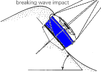

The Jeanneu Sun Oddesy at 32’ has 24% greater length, and a 39% greater beam.Delevi wrote:
I like the high freeboard. Makes me feel safer in heavy seas. Keeps the waves from washing overboard and I like the extra room in the cabin. No experience with an S or D Mac, but the M is quite stable under sail, despite the freeboard. Only exception would be sailing a broad reach in heavy winds with big quartering waves. I believe this is the boat's most difficult point of sail under such conditions. However, I understand that most sailboats experience this problem. When the Admiral and I chartered a boat in Greece this summer, we encountered 35 kts and big seas, sailing about 25 degrees off the wind. The boat behaved much like the Mac. I had to drop the main and sail under genny alone, which kept the stern from being knocked around.
This was a Jeanneu Sun Oddesy 32 w/ bulb keel. Plenty of freeboard in that puppy.
The “M” "HIGH"freeboard/narrow beam with its daggerboard & water-ballast can hardly compare with 11 feet of beam,
and a lead bulb keel sailboat having more than 5 times the displacement.
Freeboard, within reason, is to be desired.
However, excess freeboard provides windage, weight, and vulnerable structure up high... structure that cannot be reefed when the weather kicks up.
Until the 1960s and 1970s, free-board—the height of a boat’s deck edge above the waterline—was comparatively low on sailing yachts but often substantially higher on powerboats. Low free-board didn’t help a sailboat’s accommodation space, which was already constricted by narrow beam, but it certainly added to a boat’s looks. Sailboats from that era are still greatly admired for their pretty sheerlines and graceful overhangs. Production cruising sailboats added freeboard to help reduce the height of ugly deckhouses needed to satisfy the new demand for standing headroom in small boats. Because most production sailboats today are fin-keeled and flat-bilged, their cabin soles are not as deep as in a traditional sailboat. In the search for headroom, the only place to go is up. Freeboard creates windage, so the more freeboard you have, the poorer your performance to wind-ward. In a storm, high freeboard also gives a breaking wave a bigger target. It is difficult to know the truth. Freeboard is far from the only factor contributing to a large range of stability; it may not even be the major factor. And there were no protests in the old days about lower freeboard making boats less safe. So it seems quite possible that modern designers are putting the best face on a feature that exists primarily for creature comfort and has little to do with seaworthiness. On the other hand, high topsides expose a larger surface to the energy of a breaking wave and also move a boat’s center of gravity higher, especially when combined with a high superstructure. In heavy weather, a high center of gravity is the last thing you want. Consider, too, the windage of high topsides and superstructures, which will make a boat harder to handle in high wind.
