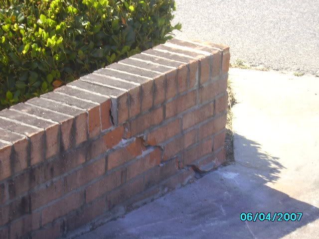

Boblee wrote:You're lucky yours are still hanging mine had an altercation with a concrete and steel post designed to protect the petrol bowser, so new ones are in order but they were too skinny anyway.
Don't feel too bad. I had a run in with the low brick walls that were on the side of my driveway. Had to get a friend and a large crow bar to pry the fender away from the tire.
Here are some pics. You can see the crack in the brick wall where I broke it. My landlord charged me $500 to replace :!: :x
And here is a pic of the fender after I bent it back out away from the wall. Oh well...live and learn :wink:
A little black spray paint and it is now hard to notice unless you are looking.
Turning radius is important :!:
