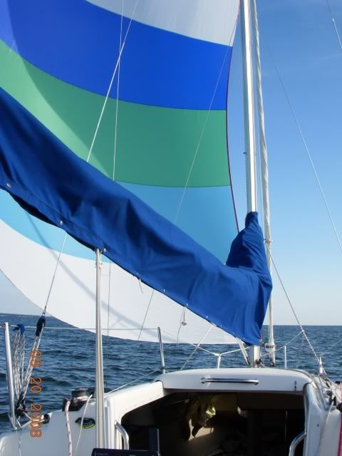

Gary,One question: is the picture of the spin flying before or after you added the higher hound?
If you are referring to the photos included with my post at http://macgregorsailors.com/forum/viewt ... =9&t=10945 --- in the top photo the spinnaker is flying from the stock jib hayard, in photos 3 & 4 it is flying from a dedicated halyard secured at the added, higher mast hound. Here is a more recent shot of us sailing under spinnnaker alone which shows pretty well the arc of the luff. In this photo, we're on a broad reach so the spinnaker tack is set at the height of the bow pulpit. On a close reach the tack would be pulled down to the top of the furler drum, straightening the luff a bit more.
Doug
