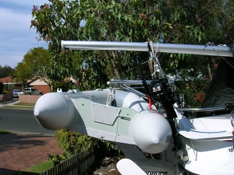

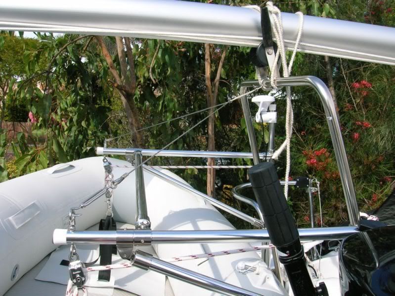

This is a Mod I have been thinking very hard about, davits and a swimstep are rising to the top of my list. After searching the site hard I was unable to find any entries so I looked into my photo cache for a mod I remember seeing. This is not my boat or my mod but here are the photos:
I hope to do it differently, but with this basic idea. I am considering aluminum channeling for the arch and davits. Hopefully I can get them done soon.

Here is the original thread that those photos come, from plus towing ideas:

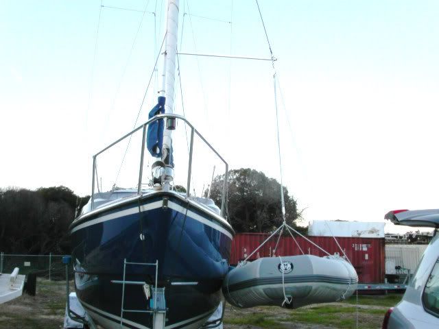

I'm looking at putting our inflatable on the bow upside down while on the trailer and use a hoist similar to Oskar 26M's for deploying

The davits kadet use look good, is it harder to get onboard your boat when the dinghy is in position? looks like it would be.
