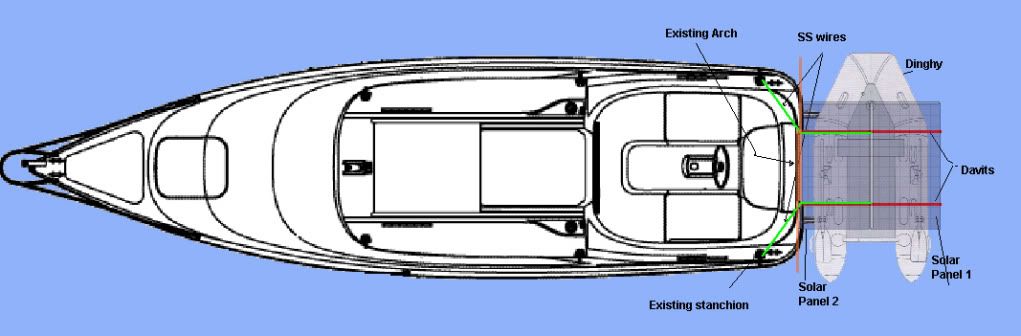

Hi guys
I've recently bought two Unisolar US64W Solar panels and need to find somewhere to fit them when cruising Shark Bay next month.
As an interim solution I plan to use the 'wings on the Mac solution KayakDan proposed here but if possible I would like to hang them off the stern of the Mac as others have done.
When my 8 ft dinghy is inflated, I usually either tow it or carry it on the foredeck. Towing is okay, but it really gets in the way on the foredeck. I would prefer to hang the dinghy off the stern using davits.
If possible I'd like to combine the two functions as below: What do you guys think??
On edit: the solar panels each weigh about 9 kg, the dinghy about 33kg so all up around 51kg

Have you seen DaBOB's arch?
I'm copying it and going to mount solar panels on top.It helps if you can adjust panel angle instead of leaving them flat.You can generate heaps more power that way.
Is your davit assembly going to be removeable?
There's a rear projection rule that only permits limited overhang.The transport inspectors love giving out $400 fines for that one.

Oskar 26M, I've been playing around with similar ideas to you, one of the things I came up with is to put one of the solar panels over the driver's seat and the other over the outboard of our X, that would reduce loading on the davits when both panels are behind the arch while on the road, I'm also thinking of putting some aluminium channel above the stern berth to store both panels while trailering or while in storage, if I go down that track I would think of hinge down davit arms.
Anyone with a link to DaBOB's arch or is that this one?

I think that the pic you posted is DaBob's arch. We hadn't really considered it but having been reminded, it might be worth a shot. It could work better than adding guy wires to support the extra weight. We like your idea for storing the panels when trailering . We also intend to take mine off and store inside when trailering and that's a great suggestion.
Keith:
We do intend the davits will be removable, but they should also fold back against the transom when not in use.
DaBobs arch should work as a solar panel mounting point too, though davits would still have to be added. We would like to have articulated panels to increase the output, but cost might defeat me. :(

However, I do not think that the brackets would be sturdy enough to carry the panels AND a dinghy.

The arch shown in the photo would need a bit more structural reinforcing before it could be used to carry a dinghy but that is the concept needed with a bit more rake.

One of the ideas that passed through the grey matter was to build a permanent Binimi over the rear of the cockpit from the pedestal (behind boom) to the stern with a solar panel on each side of the center line, the davits could hinge from the rear with removable supports that would hold the davit arm horizontal when needed, a traveller could also be added to the front edge of the bimini/panel/davit tower.

While solar panels on an aft arch is a great idea, I plan to put some on my custom arch someday, I think hanging the dinghy off the back is a bad idea. In addition to the extra length, weight, and conflicts with the motor and rudders; any reasonable sized dinghy (one longer than 7'10") will stick out past the sides. This will make docking more difficult. You could never ba able to lay up beside a wall when doing things like going through locks.
These boats just don't need, nor should have, dinghys hanging off the back. I've always thought a dinghy on davits looks wrong on any sailboat (except a catamaran). That way of carrying one is a powerboat thing. I much prefer my compact air floor dinghy rolled up on the bow when under way, it is completely out of the way there and actually makes a nice seat. It inflates easily on the bow in under 10 minutes without breaking a sweat using a good foot pump and gives me a 10' long dinghy that can carry 6 people and the dogs.

The cockpit trailering idea sounds but the scale drawings suggest that the panels wont fit flat in the cockpit of the :macm: :(

The permanent bimini idea sounds good... would it get in the way a bit when packing the boat for trailering?
Duanne:
I've seen quite a few yachts with dinghies on stern davits where I sail, although most have been bigger than the Mac. You make a good point about the overhang and that would definitely be a problem for a 10 ft dinghy. The drawings in my first post are to scale so I'm hopeful that it wont be a problem with my small dinghy

Oskar 26M wrote: Glenn:
I don't know how you load your boat, (you might have a way to load over the side), we load from the stern, a permanent bimini could be made to bolt to the boat in the same spots as the arch and the sides behind the cockpit cushions, giving you a tunnel of sorts.
