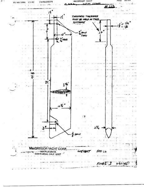

Post by rgranger »
A few months back I got a burr up my (you know what) and sketched a design for a new Keel for my V222.
Here is an image.
And I can mail you a *.doc if you would like more details in the construction.
Rob

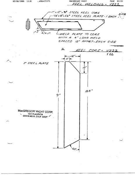

I don't remember where I got these:

Wow Bob--those look great!! Those are probably what I am trying to get from MacGregor!!. Hope they are the right ones for my boat. Thanks a million!!

I got the guy at MacGregor to send me a sketch of the keel. My father in law and brother in law are going to take a shot at building. My father in laws idea was to take some scrap 1/4" steel he has, cut into four pieces and weld it into sort of a stretched diamond shape. Then, depending on the weight, adding steel shot if need be. Or, he said for a little more cost he has a friend that could bend two pieces into shape so there would be no weld on the sides. They also have the means to lift the boat with no problem. This is great!!
