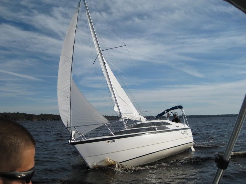

I don't have a video...yet. It is on my "to do" list for when I get back.
But here are a couple of pics if that helps at all.
These were all taken Dec 31 2008 by JCasale in the St. John's River in Jacksonville, FL. I did not get the halyard tied off properly and the luff got a little loose on me but since we were going well I didn't bother to tighten it back up that day...so please excuse the ugliness. Didn't hinder the sailing though IMHO. I find reefing first but leaving the full 150% Genoa works for me. Then once I start heeling too much I furl in the Genoa.
I have the single line "Jiffy Reef" system that is led back to the forward/port side of the cockpit. Makes it quite easy to do single-handed which is the way I sail most of the time now. If the winds are up I reef from the get go before I even raise the main for the first time. My technique if reefing while I am out on the water and in the wind:
1) Heave to -- works great (helm locked hard over by the S1 Wheel Pilot engaged but off)
2) Slide forward on the starboard side of the cockpit and loosen the halyard (mark on my halyard for approximate halyard position while reefed)
3) Switch over to Port side and start pulling on the reefing line. With halyard loose the main will fall on it's sail slides. Reefing line will pull the tack down tight then keep pulling as the clew comes down to the boom. I pull it as tight as I can possibly get it. Then secure the reefing line on cleat at the front of the cockpit.
4) Loosen the vang by leaning up on the sliding hatch (this line is not led back)
5) Switch back over to starboard side and pull the halyard to get the luff tight again. Secure the halyard on cleat at front of cockpit.
6) Pop the Genoa sheet to "Un"-heave to.
7) Adjust main and genoa sheets as necessary. Off I go.

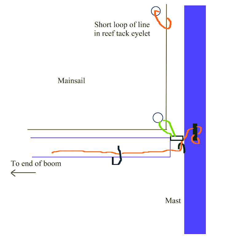

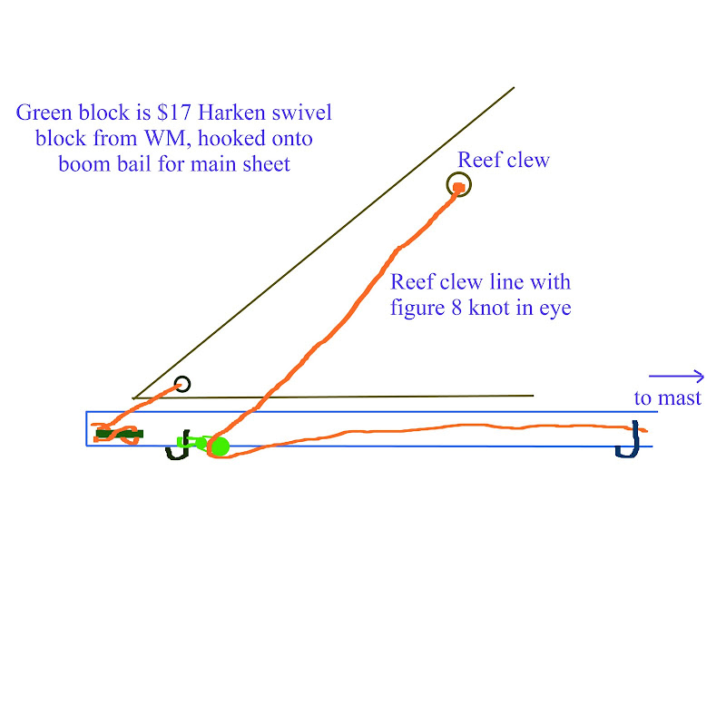

I thought I would give my personal reefing experience. It is still a work in progress, but I was in need of improvement in my reefing.
Jim above has described the best method with lines led aft. It will cost you some dough for blocks, cleats and lines.
However, I came up with a $17 half-way solution.
A few days ago in 10 to 15, I was alone and practicing in a wide channel. My reefing was a disaster as it always was. I managed to get it done but sloppy and 3 to 4 minutes before it was complete. That included chasing reefing lines that I am too embarressed to explain where I had them. They flapped in the breeze as I grabbed for them.....
After studying this forum and books at the library, I made a list of all the things I needed. I liked what this website had to say http://tritonclass.org/articles/linesaft/reef.html
When I took my sketch to WM and priced it all out including lines I was about $200. I said to the WM rep I would think about it.
I went back to the boat and did think about it and practice various things until I came up with the solution I will describe here. I used a spare $17 Swivel Block and some spare line as my sole investment in reefing.
Here is my procedure, refering to the pictures below.
1. Luff mainsail and TIGHTEN TOPPING LIFT. If you don't have your topping lift on, the boom will fall on your head. Ask why I know this.... Also, loosen boom vang.
2. Release mainsail from cockpit cam cleat to premarked position (magic marker on main halyard.)
3. Use downhaul to help bring down main to premarked reef position. (Downhaul is just a line connected at the head of the mainsail right where the main halyard is connected and then run down the mast to a block and then to the cockpit.)
4. So far, I have not left the cockpit.
5. Carefully go to the mast and hook short line in the reefing tack eyelet to the rams horn hook at mast near where boom connects to gooseneck.
6. Haul the reefing line that is routed from the reefing clew eyelet, around a Harken block slightly aft of the eyelet on the boom (hooked the swivel to the mainsheet bail) thru the boom vang bail, using it as a fairlead.
7. When tight, run reef line under same rams horn and then cleat it off on the mast cleat above it.
8. Back to cockpit, raise mainsail tightly.
9. Tighten mainsheet, adjust topping lift, and sail away under reefed main. You can tie the reefing lines that secure the loose mainsail to the boom if you want to look neat, but you can do it when you have the chance. The boat will sail safely without tying these lines, but the loose sail may billow a bit at the boom and look bad.
suggestions welcome.
