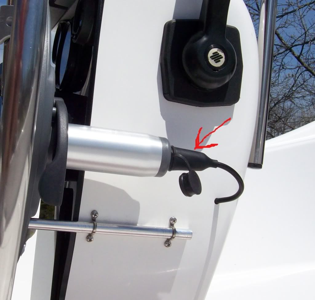

Would anyone know of a source to get a boot for this connector....apparently Raymarine uses extremely low quality rubber, it is basically "melting" if you touch it, the black rubber rubs off like charcoal .....

Put the motor inside the pedestal like I did no worries

First is to clean the connections inside. Let dry and the put electrical tape, then liquid electrical tape a couple of times. Reapply electrical tape and then some more liquid electrical tape. This should keep it dry inside and easy to remove.
Also, Get a pedistal cover. Less than $ 200 and will save sun damage.

Try some heat shrink
it comes in different colours and available at a lot of places

Black elctric tape works ands looks great. You only have to put it on the outside. It takes 5 minutes and costs 50 cents and has lasted 1 season and still looks like new.

I do keep it covered from the sun so I do not feel that is the reason...... I use a cover and a bimini ......it is just lousy quality rubber...
I think I will cut it off and just use Silicone tape: http://www.rescuetape.com/
as not to make it "sticky" from eletrical tape
