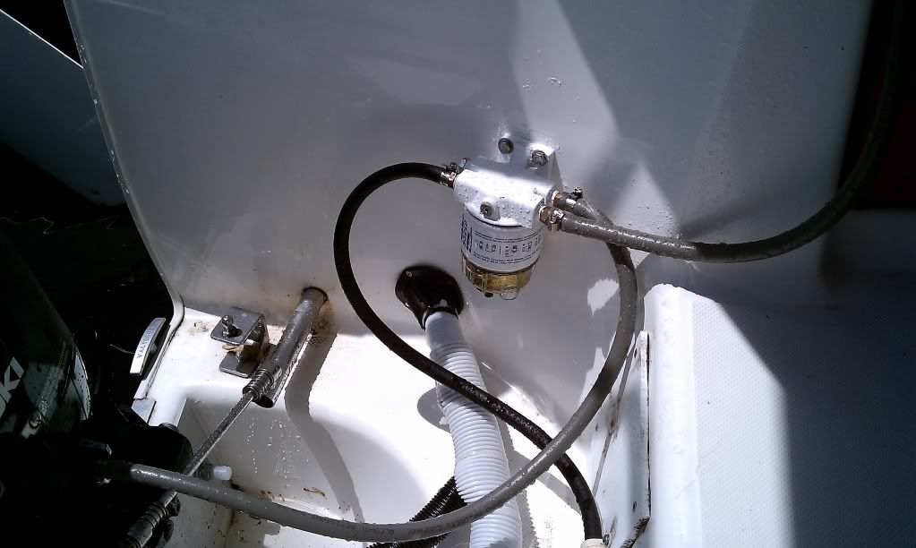

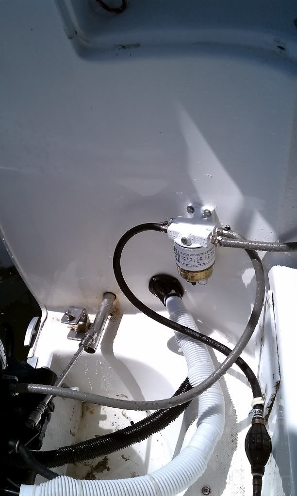

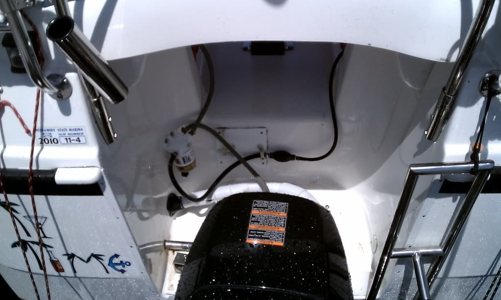

Dave, More info here from my original post:
http://www.macgregorsailors.com/forum/v ... 62#p185862
I have a valve where it connects to each tank (I do this so as I am always aware of the fuel status 1 open 1 closed) and yes they are plumbed to the filter directly
The filter has 2 inlets and 2 outlets (1 has a plug)
Manufacturer: RACOR
Model #: 120RRAC01
Spin On Series Fuel Filter/Water Separator - 30GPH, For gasoline engines only.
Fuel filter with mounting head, spin-on element and see-thru bowl.
Features:
See-thru plastic bowl
Coated to prevent corrosion
Four 1/4" ports; two inlets and two outlets
Use on vacuum side of fuel or transfer pump
Manufacturer: RACOR
Model #: 120RRAC01
Features:
