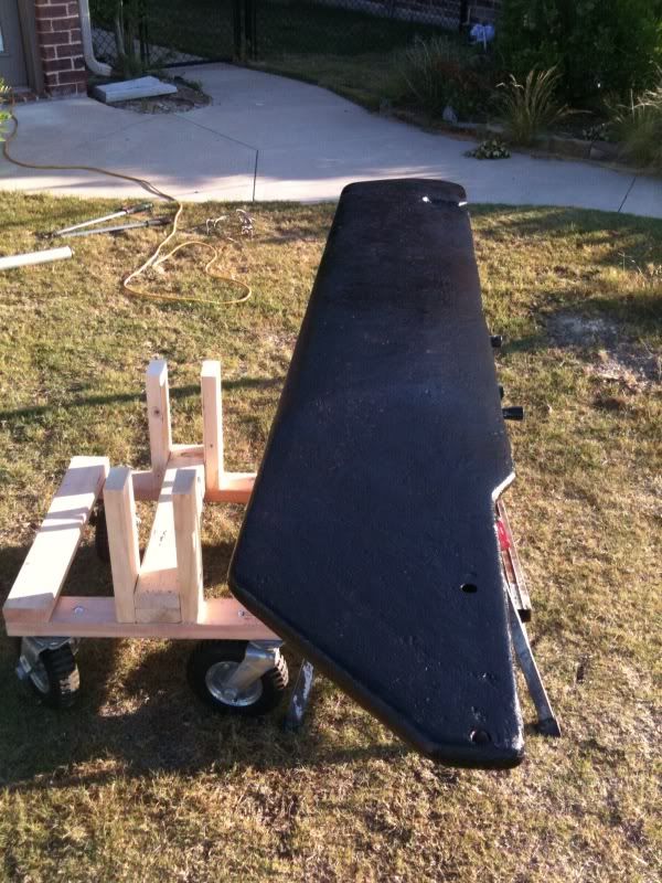

The first thing I did to my boat was remove the keel. It is super heavy. Getting it out was not too hard - a controlled avalanche. Getting it back in required a little more thought and I built a dolly to hold it in place so I could jack it up inside the recessed area. Here are a few pictures:
Here it is after removal and placing on a workmate (took three strong people to get it up there)
After sanding and painting. (same helpers to flip it over and paint other side)
A dolly made especially for positioning the keel for installation (added a fourth helper for this task)
Did I mention this is super heavy? The pictures don't do the weight of this thing justice. Even with four people, we never actually lifted the whole thing. We just lifted half, then slid stuff under it, then lifted the other half.
While it was out I ordered a new pivot bolt with washers and rubber seals and new winch cable.
