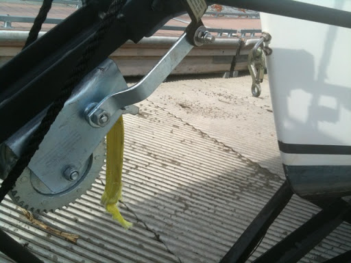

While pulling our boat last weekend our brand NEW winch webbing failed. Luckily we always watch the boat as it comes out of the water and pull up very slowly. We also attach some line between boat and trailer just in case. Happy to report all is well....

WOW! How could that have happened? Was It the ....Stitching? Frayed? Damaged? Sabotaged by The EX! :x

I was hauling my :macm: up the mountain to Big Bear Lake when the webbing became slit and broke. I was able to tie it back together to get up and then back down the mountain.
I approached Mike Inmon and suggested I wanted a replacement steel cable and he said "no way - - they are too prone to twist and snap - - - let's find out what caused your strap failure and fix it" - - - which we did - - - turns out there was a sharp piece of metal on the winch that had nipped the strap and caused it to fail. So we replaced the winch and the strap and I never had a problem again - - - but Mike was emphatic in his advice to NOT use a cable.

Our winch strap failed as we were pulling our boat up the ramp. I was in our F-150 and heard a big "Crack". I immediately stopped and saw that the strap had failed. We tied the boat to the trailer using several wraps of a heavy-duty dock line. We pulled the boat out of the water, did the Mac "bump", and then retied everything.
When we got home I replaced the strap with a very heavy-duty model. No problems since then.

These straps are prone to failure due to rot from dampness & UV it does not matter what you use but their is nothing wrong with SS cable my electric boat winch & suv electric winch both have SS cable Its a lot more expensive than the cheap strapping your winch comes with & the reason you hear of so many failures of these straps is because the winch is only rated 1100# so the strapping will most likely be the same your boat weights in @ 2500# mty zero motor, sails, fuel , gear ect so you do the math & you don't need to be a professor to figure that one out EH !

My strap broke the weekend before last, which happened to be the first time I've had my 26X out since I bought it in September. The strap had obvious deterioration as a result of sitting in the sun. As soon the boat started to clear the water I heard a "Creek-Creek-SNAP". I went back to see what had broken and found it was the strap. I pulled out a couple of feet to get to some that wasn't suffering from UV deterioration, tied it to the boat and finished pulling it out. The boat had only slipped a few inches down the trailer.
It was just the icing on the cake for a day when EVERYTHING went wrong. Luckily neither this nor any of the other mishaps caused any real damage. I replaced the strap today.
