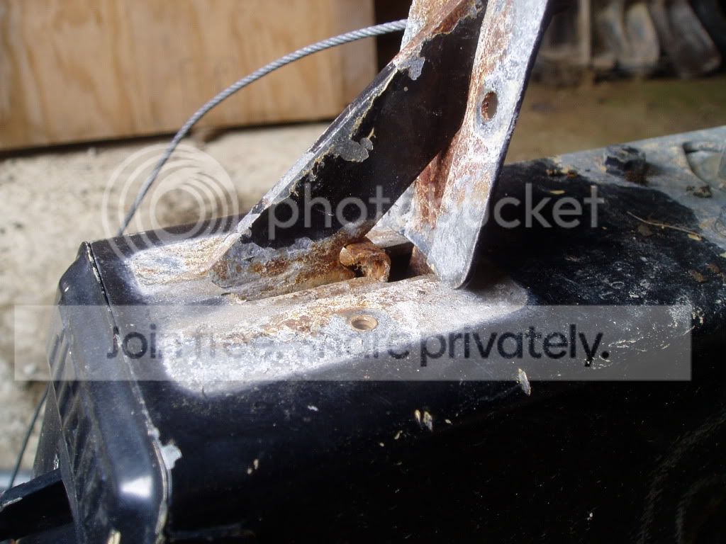

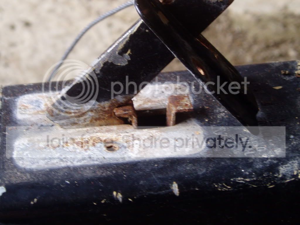

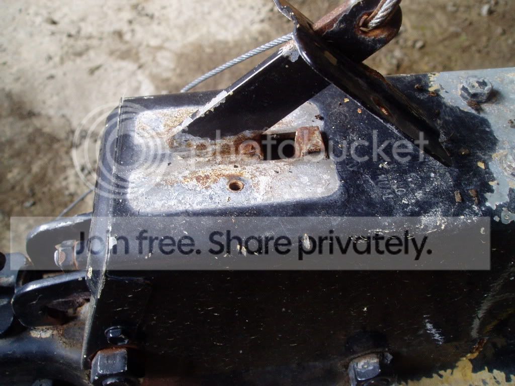

Its been a long time since I posted pics, but I'll try. It will be a good refresher.
This is the cover plate removed. You can see the spring tang engaged with the slot in the lever.
Here the lever is tightened slightly.
Here the spring is raised slightly to let you get a better idea of what it is.
The lever has another slot at the bottom of its arc. If it is fully engaged the spring will lock in that lower slot and hold the lever fully engaged. I guess it is a safety thing.
Hope this helps as this is a stock X trailer. I'm hoping your M is similar.

Nope. Not even close. Totally different actuator. There is a release on the underside on the M actuator, but it is usually when you are bleeding the system. The M has a shock absorber and spring systemRetcoastie wrote:Hope this helps as this is a stock X trailer. I'm hoping your M is similar.
