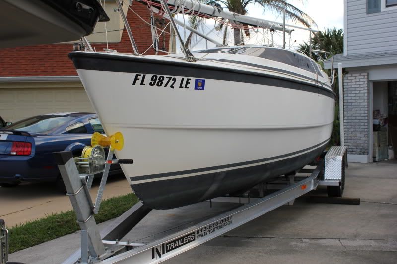

Finally got my new trailer on Friday and its a beauty. Tim Nobles (TNT Trailers) made it and he makes a lot of rebranded trailers so you may not recognize the name but he makes a lot of trailers out in the Brandon area. He had the best price and the best service, even loaned me a tandem trailer to pull my boat out of the water with since my Mac trailer had become unroadworthy. Its got all the goodies, Aluminum, Torsion axles, SS hardware, etc. It is the extra wide 102 inch version so that the boat can sit lower than the I-beams. In fact, its not much higher than my original Mac trailer but with a much longer tongue so I expect it should be pretty easy to launch and retrieve. I think he did a great job on the bunks and basically built them around the boat itself to give some incredible support. There are 4 2X6 bunks that are extremely long and contour around the hull perfectly. I thought that the middle set of centering bunks were only going to be used during retrieval but they hug the middle of the hull even when the boat is all the way to the bow stop.
It is extremely stable on the road. I drove it back from Brandon on Friday and it was a dream how well it drove. I momentarily took it up to about 75mph on I-4 and it felt like I could easily go much faster if I wanted. The Mac trailer used to start to feel kinda unstable at those speeds. For the extra $500, I didn't go with the fully SS disk brakes but this one does have the silver cadmium disc brakes on the front axle and they work very well. There seems to be some controversy on some of the web blogs about whether the SS rotors are worth the extra money since those won't be the parts to fail. Tim gave me some good advice on those too and that is to make sure that the actuator is always retracted before storing the trailer otherwise the calipers will corode faster. The way the coupler works, I don't think I can de-couple the trailer unless the actuator is retracted anyway.
As I mentioned, I got very good service out of Tim and he will still be building me some sort of bow ladder either as an attachment or some ladder legs on the post. He even mentioned that he could come by my house to do it instead of having to pull the boat and trailer back to Brandon again. I also got a spare tire included but he had run out of mounting brackets so that will also be mounted when he comes over to do the ladder. I'm including some pictures here with the boat on. Once I take the boat off, I'll take a few more pics so you can see how long the bunks are. I'm still really impressed by that as I have not seen any other manufacturer build such comprehensive support into a trailer. I think this is where I did better by having a trailer custom built to form fit the boat exactly versus trying to fit some other trailer to the boat. The loaner trailer I used was just your standard power boat trailer with vertical cyprus bunks and the boat was obviously just supported in three small places and felt a bit wobbly and very high up too since it was several inches above the beams.
I'll be all ready for Cayo Costa in two weeks when it will get its first 200+ mile test drive!

I'm still waiting to see if Tim will charge me extra for the ladder or not. He has welded it up but its currently waiting to be hot dipped galvanized later this week. I need to take the trailer back due to a couple minor issues with its first 250 mile trip last week. For example, the brakes were activating when I backed it into my driveway and that is not supposed to happen. But I think he will get all this stuff resolved for me and I may decide to take an even longer trip down to the Keys in a about a month.
Here are some more pictures:
From behind at Eldred's marina parking lot right before loading it after a 3 day trip down to Cayo Costa
From the side, you can see the spare tire which was included.
Closer up from the side, you can see how long those center bunks are!
