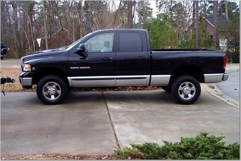

I just got my new tow vehicle- Dodge Ram 2500 4WD with the diesel and a 6sp manual. It is rated at over 12k towing so I may have overdone it a bit but in the right direction at least. Drove it first time today- the owner's manual actually recommends towing early in the engine life to help it break in faster. The brakes are strong and I can get an add on exhuast brake (towing the Mac won't require that). I am looking forward to hooking up the Mac and seeing how it goes.
